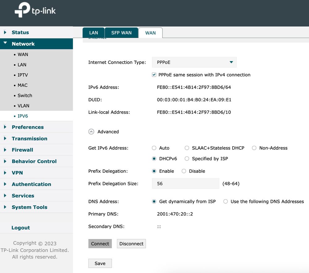

Ok, I seem to have this working - to an extent with the following settings...
However as soon as the router connects, I seem to get the following entry into system log at 1 or 2 second intervals
Is this normal?
If, as I suspect not, do you think it is due to my settings or a "feature" of the ER605?
Ian

Is this normal?
No, looks like its constantly trying to renew the connection.
Looking at the manual , for the 'Get IPv6 address' does selecting SLAAC + Stateless DHCP make any difference , or even AUTO ?
I'm actually using an ER605 myself, The hardware is good but I'm afraid I gave up on TPLink firmware some time ago and flashed it with native Openwrt. It obviously doesnt work with the Omada controller and is a one-way trip, there's no going back to the factory firmware. Quite a steep learning curve as well...
Re: IPv6 on a TP-Link ER605 router
25-04-2025 1:26 PM
@MisterW for the 'Get IPv6 address' does selecting SLAAC + Stateless DHCP make any difference.
If I use that, the "IPv6 address" field remains as :: and the Lans only have link local addresses.
If I use Auto, I seem to get the same result as using DHCPv6

@IMM that's sort of what I expected but it was worth a try. AIUI it should be using DHCPv6 to get an IPv6 prefix.
If you look at my Openwrt configuation for the IPv6 WAN interface below
Its set as a DHCPv6 client and uses the existing PPPoE tunnel (@wan) to communicate. I assume in your case thats the 'Use same PPPoE connection as IPv4'
It definitely shouldn't be logging a connect attempt evry 2 seconds! I'd suggest posting on the TpLink business forums to see if anyone has any ideas https://community.tp-link.com/en/business/forum/794?page=1

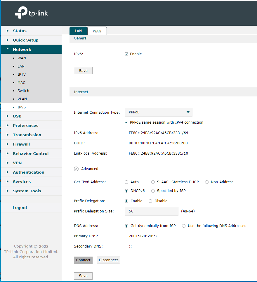

My ER7206 also shows a link local address and when connected stops internet access

26-04-2025 11:24 AM - edited 26-04-2025 11:26 AM
So my ER7206 is doing the same. The clients are getting addresses OK

Just to add my other IPv6 wan connection isn't filling the log.
It would appear the router can't cope with two IPv6 wans as the PD has to be specified in the lan settings and therefore can't fall back to the other wan in the event of failure.
