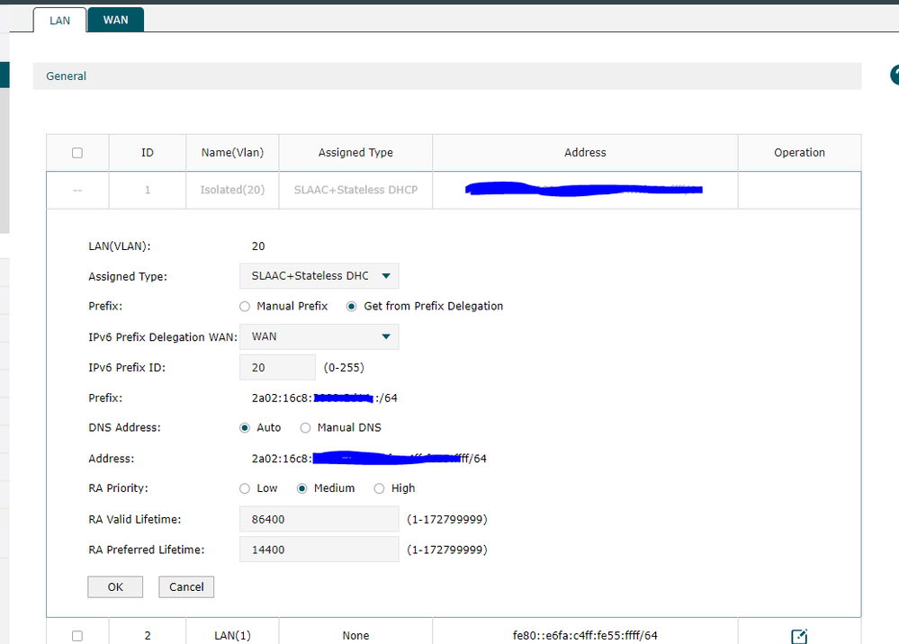

@IMM wrote:
I don't understand why the IPv6 address seems to be a link local one but when I set up the Lan as below, I seem to have IPv6 connectivity.
Yeah, I'd say you have IPv6 connectivity too. What does the output of ipconfig (or ifconfig) on a client say? Alternatively, how is a visit to test-ipv6.com looking?
As @MisterW said don't be too misled by the apparent lack of a global IPv6 address on the WAN. It isn't required for general IPv6 connectivity as the link-local address on the WAN port is sufficient for this. It'd only be needed for things link remote configuration over the Internet, or perhaps certain types of IPv4-IPv6 transition mechanism.
Incidentally, my Dratek router *does* happen to have a global IPv6 address on its WAN port (as well as a link local). It obtains a /56 prefix from Plusnet via DHCPv6, assigns the first /64 to the WAN (and creates a /128 address from it to the WAN port using SLAAC) and then assigns the second /64 to the LAN from which clients can either generate their own /128 addresses using SLAAC or request one via DHCPv6 from the router.
