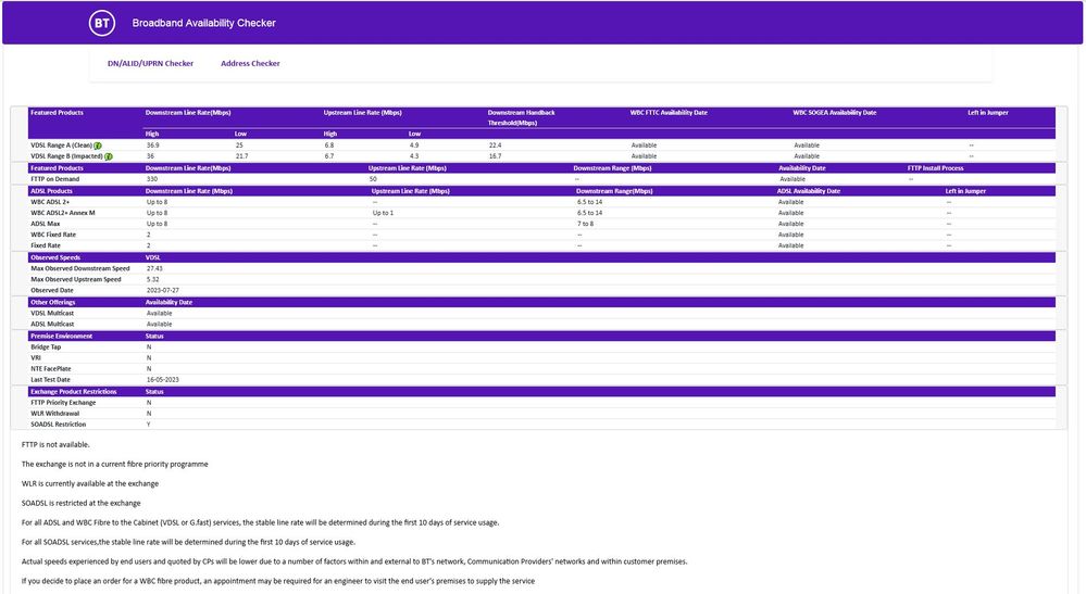

Can you post a screen shot of the results from the following so others who are more knowledgeable than me can advise on your options. Remember to hide your personal details.

Many thanks, much appreciated.  Here's a screenshot from that website (haven't a clue what a lot of it means I'm afraid!).  The speeds quoted on it are very optimistic, the best I've ever seen has been about 19Mb/s and a lot of the time it hovers around 18Mb/s download at best, with much slower upload speeds.

@JSHarris Excuse me for jumping in here. I can't advise on the phone side of things, but that BTw report says you are getting 27Mb/s to your master socket - you should be achieving around 23Mb/s on a speed test. Which Hub/router are you using?

The key bit is to the right of the header - WBC SOGEA is available. This is the internet only product.
https://www.openreach.co.uk/cpportal/products/fibre-broadband/sogea
The next question is do PlusNet supply a product using it.
