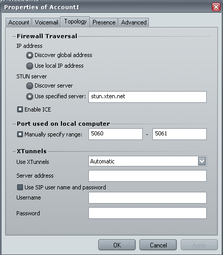

Hi Mark,
Perhaps you could post a screen-grab of your settings. One thing you might want to make sure of is that you have the relevant ports forwarded in your router. I'd also suggest the use of a Stun server:
TBH, I'm not sure how your hardware interacts with X-Lite (do you need to use both??).

Re: Ring delay on voip, any answers?
Quote
I guess the usb phone is acting as a headset.
opening ports on both router and software firewall will definitely help with delay, also there are your QOS (quality of service)settings in the router to increase the voip services priority over your bandwidth.
Handy if your dloading while on the phone or your part of a network.
