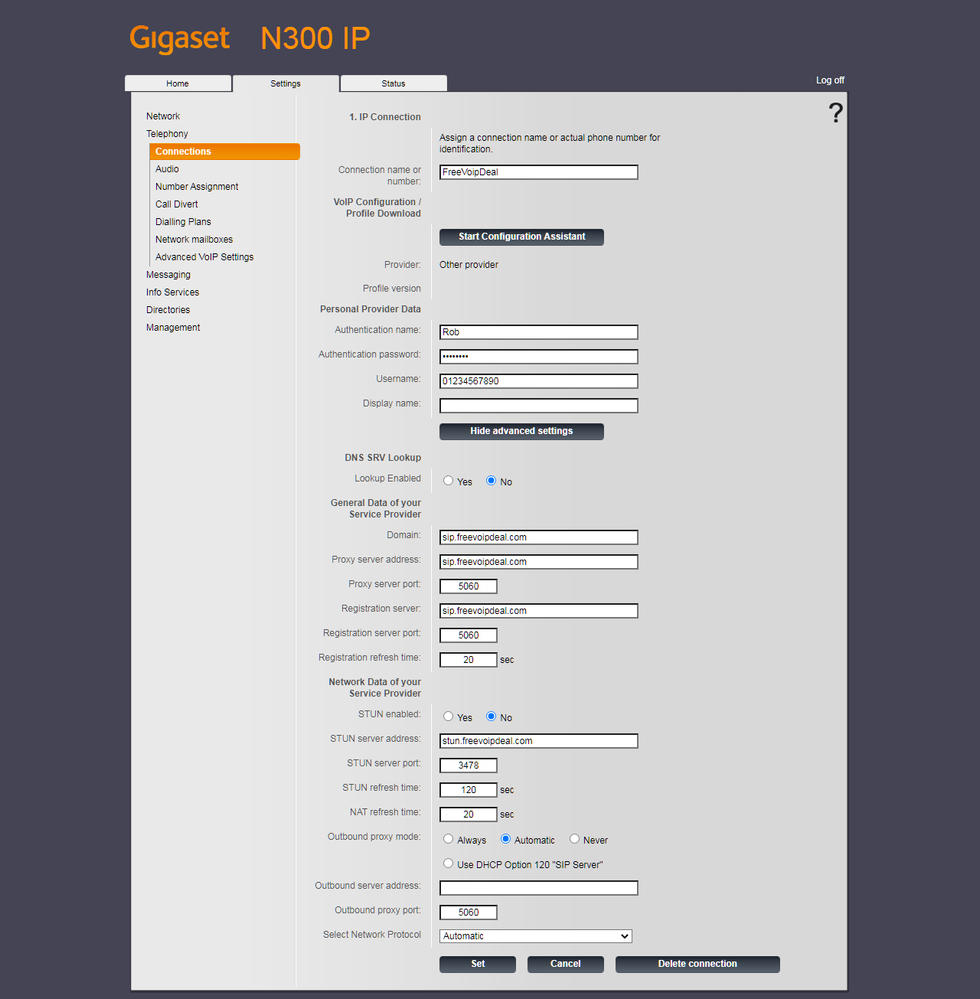

@dejjones wrote:
Below is what I believe to be the relevant config. details.
@dejjones
For comparison I've attached a screenshot of the FreeVoipDeal settings from my Gigaset N300IP with 'Authentication name' and 'Username' (phone number in this case, see my earlier post) changed for obvious reasons.
Having just had a bit of a play with the settings I can confirm that the account still registers with any or all of the fields listed below BLANK, although I didn't try making any calls or leave it in that state for any length of time.
Proxy server address:
Proxy server port:
Registration server:
Registration server port:
Although I have entered STUN settings STUN is not being used (can't remember why I entered them).

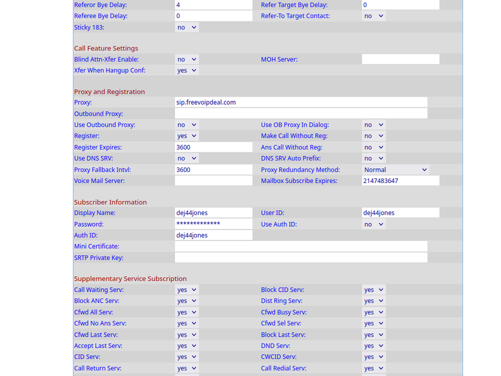

dejjones
Posts: 167
Thanks: 14
Registered: ‎31-07-2007
Re: Renewing contract and maybe moving home phone to fibre...
Thanks for all the feedback
I think I've tried all of your suggestions and many others.
FVD's instructions say leave Outbound Proxy blank, so they clearly do not need that, (I've tried putting their Proxy Server name in there, anyway, with and without the (sip.) to no avail.
My existing account registers OK with only 3 fields filled (Proxy, Password & User ID)
I think my only chance is to find someone who has an SPA 3102 with an FVD account.
I have it working on the mobile app so will settle for that meanwhile.

dejjones
Posts: 167
Thanks: 14
@RobPN
@PNnewbie
@MisterW
@paul_blitz
I've just managed to register, and am now able to make calls!!!
I changed "Use DNS SRV" and "DNS SRV Auto Prefix" from "yes" to "no" and that allowed registration.
I have no idea why this works.
I have attached a screenshot of the working config.
Thanks for everyone's help.
Posts: 17,467
Thanks: 7,063
Fixes: 488
DNS SRV (service) records are normally used to direct incoming calls. For instance we have an SRV record for our office PBX system which defines a main and a backup pbx. The SRV record is configured in our A & A control panel as the destination for incoming calls, and it means that incoming calls will try the main pbx first and if that doesnt answer will revert to the backup.
Not sure why anything to do with DNS SRV SHOULD affect registration but ...
From here https://community.cisco.com/t5/voice-systems-and-accessories-small-business/spa-3xx-5xx-configuring-...
When DNS SRV is enabled, SPA phone performs DNS SRV query first and performs A/AAAA record lookup if no SRV records were found,
However, If auto-srv prefix parameter is enabled, phone will only try DNS SRV and will not fall back to A record.
So I suspect it was the Auto-srv setting that was preventing the spa3102 resolving the freevoipdeal server url correctly. It was looking for an SRV record on freevoipdeals DNS which probably (quite reasonably!) doesnt exist
RobPN
Posts: 5,362
Thanks: 2,845
Fixes: 13
Registered: ‎17-05-2013
@dejjones wrote:
@RobPN
@PNnewbie
@MisterW
@paul_blitz
@dejjones
That, along with a few other "No" settings as people suggested. Wink
As a simple End User I haven't come across the DNS SRV settings before, but as I said earlier, your device is more comprehensive than the ones I've used.
As an aside, referring to a previous post where I said that FVD (along with others from the same stable) only allow one device to register at a time, if you don't need to receive calls on that account (probably not, unless they're via SIP URI calling or you have a third party DID number pointing at the account) you could try changing 'Make Call Without Reg' back to "Yes".  That will should enable you to register the account in another device which may not have that facility and use it on both.  At least that's the way it works with my DrayTek, thus allowing the account to be registered in my Gigaset N300IP whilst still allowing calls (but with no dial tone presented) from the DrayTek.
