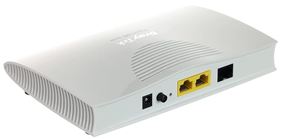

Assume that the network layout was based on the future plan for having the inevitable full fibre, where as @HPsauce says, "your" router could be located in a more ideal place elsewhere, and have it's WAN connected back to the ONT (assumed to be where existing Master Socket is) with an ethernet cable.
In the short term while waiting for full fibre, and therefore needing to use the existing Master Socket (where it is), if the aforementioned ethernet cable was 'ready' to plug in to the ONT,  then while you are still on SoGEA you could use a small VDSL modem next to your Master Socket to convert the copper broadband to PPPoE ethernet (as if it was the ONT).
Therefore when the time comes for full fibre, all you would need to do to move from SoGEA to FTTP, is replace the Master Socket with the new ONT, unplug the ethernet cable from the VDSL modem and plug it in to the ONT, and reuse the mains wall power socket for the ONT PSU instead of the the modem's power plug.
You can easily get a decent DrayTek stand alone VDSL modem on eBay for about £20.
The modem below has keyhole wall mounting slots on the bottom, so you can hang it on the wall with two screws to keep things tidy, or laid flat as shown.
