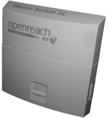

@nells2011  sounds you've got one like this NTE5Cfront.jpgis that correct ?
In which case you still need to use filters.

Ah I assumed that you had one of these https://www.amazon.co.uk/Openreach-Telephone-Master-Socket-Faceplate/dp/B07NX2KC8Y/ref=sr_1_3?adgrpi...
Your choices are either to buy one and throw away the back box or use filters. If it's not working with your current set up with filters then you either have a suspect face plate or there is something wrong with your internal extension cables or the filter.
