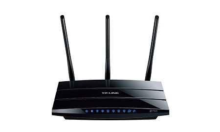

My SamKnows whitebox TL-WDR3600 is also very un-white -
