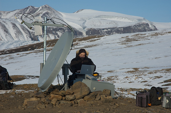

I'm having visions of what your back garden may become, shutter. Clicky.
