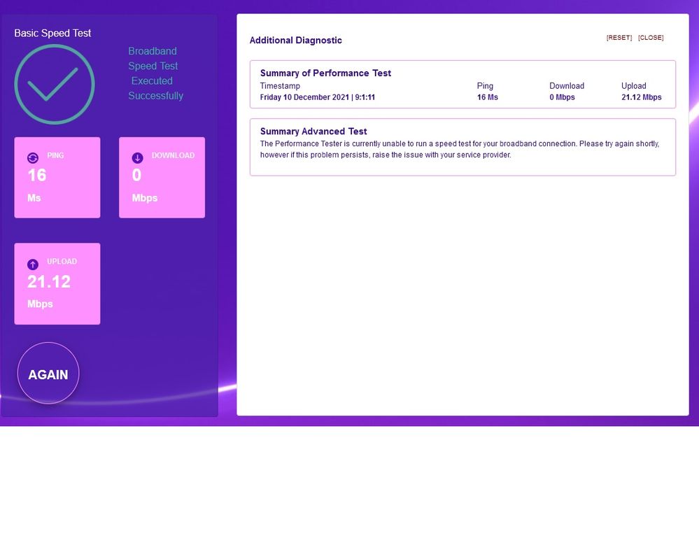

Re: slow or unresponsive internet
10-12-2021 9:26 AM
so bt engineer has been again no faults even tried us on another socket at the exchange to no avail becomeing a joke now lol

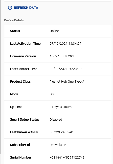

10-12-2021 2:10 PM
Hello @chilled83
Can you please provide me with the last two digits from the serial number on your router? I've had a look on my end and can see that WIFI is turned off.
There are no faults on our, as your recent screenshot of your Helpdesk page proves, 77Mbps is reaching the router, so you're losing a lot of throughput speed for some reason, which is what we need to figure out. Can you also tell me how exactly you're performing your speed tests, and what other devices are connected at the same time you're doing them?

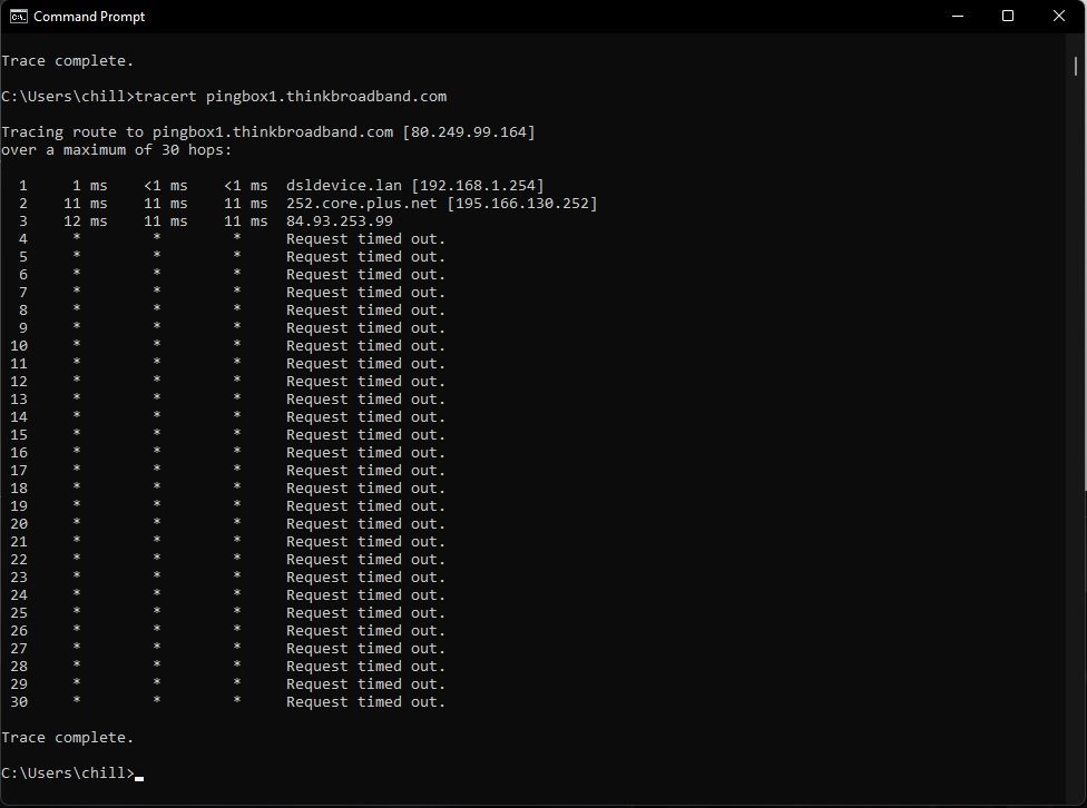

10-12-2021 3:18 PM
ive just done a tracert after going through many posts just incase

also i dont know how that could be my internet up for 3 days also the serial doesnt match the router im on the router has been factory reset allmost everyday @supports request
