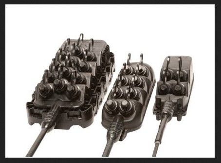

The pole will have a Connectorised Block Terminal added to it. The fibre cable is plugged into this and run overhead to your property. They look like this. The number of ports depends on the number of properties being served.
No, they look like this
Looks like that tip you thanked me for didn't sink in! ![]()
