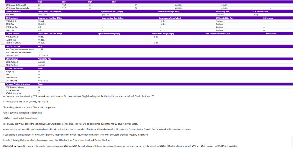

If the PN website lets you order, then FTTP is available. However, you can see for yourself. Use the following
Full Fibre shows up as WBC FTTP in the left hand column. FTTC shows as VDSL
If you post a screen image of the results (hidng your details but including the narrative below the results window) we can advise on speed.

There we go.

I just placed my order for the upgrade. I'm not concerned about losing the landline and I've got an engineer install on 12th January. Not that much of a wait, thankfully.

Thanks for the image.
You'e one of the few lucky people to have both servies available - and a decent FTTC to boot.
You've already placed your order so it's a bit late to say that FT36 and FF78 are available along with higher speeds.
You should get near your chosen speed with a much lower ping time (if that matters). The narrative indicates no problems are expected with the install (which isn't to say a problem won't be found on the day).
