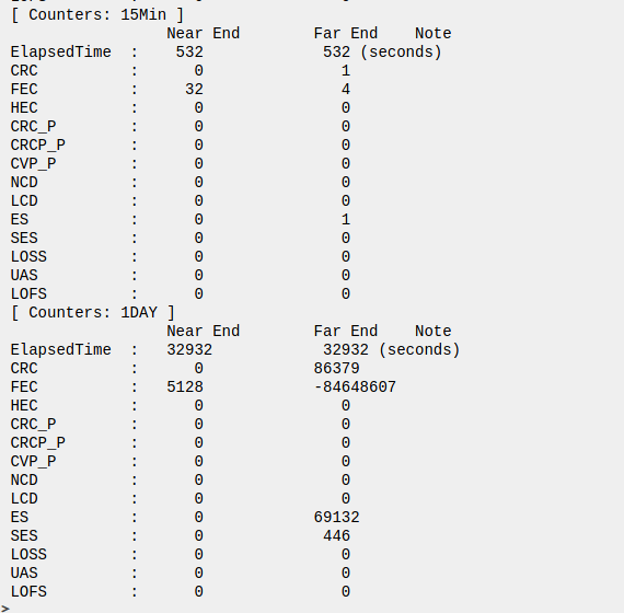

I have been plugged into the test socket most of the day as some important work came up I had to do and I forgot about it. just checked my line stats and ouch!.

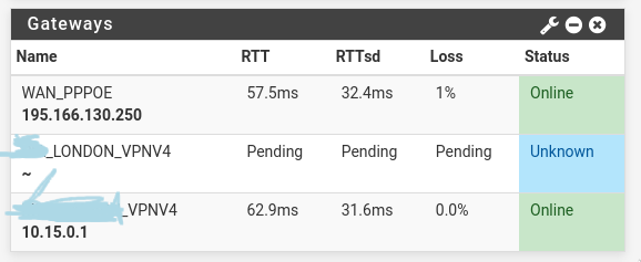

Downloading at 5.9-6.2MB/s atm but pf-sense is showing 1% packet loss on WAN whilst downloading.

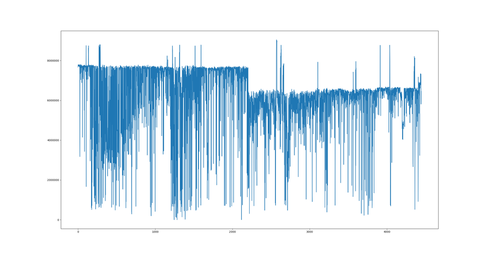

Apologies for tripple posting in one night but I had completey forgotten that i set up a cronjob about a year ago to create a sort of data is beautiful piece by running a speedtest on the hour every hour my machine was on.
You can see the trend of my ping get higher from the end of january.
Its not conclusive  because i am connected to a vpn for 95% of those tests. (fair warning theres over 4400 speed test results) and obviously the vpn servers could be having issues blah blah but here it is anyway.
I have no idea what I was intending to do with this data as obviously its  not very easy to graph 4400 data points.
that being said heres what a weird graph based on download speed looks like.

I suspect that those apparently high Far End supposedly "1 day" error counts are not correct or at least not for the time period labelled. Those Far End error counts should be for the upstream, and are counted at the DSLAM and the numbers reported back to your modem. The upstream is also unaffected by you adjusting the downstream SNRM. You can't have more ES than the number of seconds elapsed. There's no interleaving/INP on the upstream. The graph of upstream MTBE was way up in the several thousands, not down in the single figures as it would have been if you actually had as many upsteam ES in 1 day as those 1 day figures state.
I suspect that those "1 day" far end counts have actually accumulated over a lot longer than 1 day.

Yeah I believe the modem freaks out when I unplug it so one day stats become the total stats.
The day reset around 4 ISH I'll keep an eye on es. They appear much more reasonable today. Download speeds are sitting at the bare minimum of my contract requirements now though 😞

Could i get a router sent out assap because regardless of Qos limiting to try reduce buffer bloat the minute i start hitting my full bandwith by downloading streaming etc. my ping spikes to 260 ms + and i get booted from IRC which is really annoying as its preventing me from getting stuff done.
Hoping to rule out my equipment as the issue as quick as possible and get an engineer out to hopefully fix the issue..
I really hope my equipment does not turn out to be the issue as quite honestly having a second line behind an ISP router is useless for me and I might as well end my contract the minute i am able to.  I bought the Plusnet line  specifically to be able to use the fancy features of pf-sense including multiple gateway routing etc and the setup has been working fine until the past few months.
