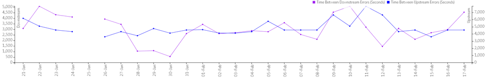

What I'd look out for are Errored Seconds(ES) or Severely Errored Seconds(SES). I've attached a graph below of the mean time between errors (MTBE) showing that your line appears to have been erroring fairly badly on the downstream.

@Gandalf  would you like to do me a massive favour please and show the my graph for my vdsl line.
I may be able to get a clue from comparing my linestats to their graph... as I've got some regular daily periods of SHINE-like CRCs over the past few days so it would be an ideal opportunity to see if it is doing anything with those.
Cheers Smiley

@kitz Yep sure thing and thanks for posting btw.
Took me a while to find your account, I've attached the graph below:

Thank you muchly.   I'll do a compare later.   Smiley
