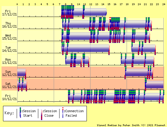

Hello, a long-time Plusnet user here, using BILLION's 8800NL router and no issues in more than 5 years with the company; recently moved to a new place and had no issues in September/October/November; the day after storm Arwen (?) hit us I noticed the occasional loss of service - no big deal. Things have gotten worse since then, unfortunately. I can work for several hours without interruption, but it's also possible that I lose my connection every 2-3 minutes; some days are better than others... mornings seem to be really bad - lost the signal several times this morning during a MS TEAMS call. Speeds are down to 5-7 mbits/s - on a good day I get 18. A BT technician came over and installed a new box and all of a sudden the speed went up to 20 mbits/s - but the next day I was down to my usual 7. PLUSNET are aware of this but I don't have a feeling they know what to do. I need a reliable connection that doesn't die on me at random intervals during the day... any idea what might be wrong?

Good morning, leaving the router on 24/7 seems to be helping a little bit - but why do I get such low speeds now? I used to get upload speeds of 15-29 mbits/s and when the BT engineer was here he was able to get it up to 30 (at least for a few minutes)... I'm now back to my usual 7... which is a real shame. But at least it seems to be working more stable now... still, quite unsatisfying.

Thanks, everyone. I've been able to work without any interruptions since 8.30 this morning, which is quite some progress compared to last week - if only the speed went up a little (currently at 7.32 mbits/s).

Hi John, is it possible for me to provide any router info by downloading a script or going into my BIOS? I was able to work for 4 hours without interruption today, when all of a sudden I lost the connection. The router tried 3 or 4 times to reconnect but it took a few minutes for it to establish a new connection. Fingers crossed that's it for the day in terms of connection issues. I do agree, even though things do look a bit better there is still an issue somewhere...
