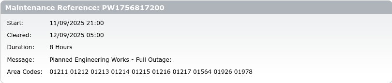

I’m based in Birmingham and using a third-party router running PFsense 2.8.1 with if_pppoe instead of mpd5 with no traffic shaping implemented. My connection had been stable for months, but during maintenance on the evening of 11th / early hours of 12th September (Ref: PW1756817200), I lost internet for about an hour with a red light on the ONT. Since then, speeds remain poor despite power-cycling the ONT and testing directly with the Plusnet Hub 2, thus removing my third-party router from the equation. Reaching out to Plusnet Support the next morning, they have said the following:
"There is a major outage in the area, which might be causing intermittent issues for your service. Openreach are replacing a card at the exchange, which is being power cycled".

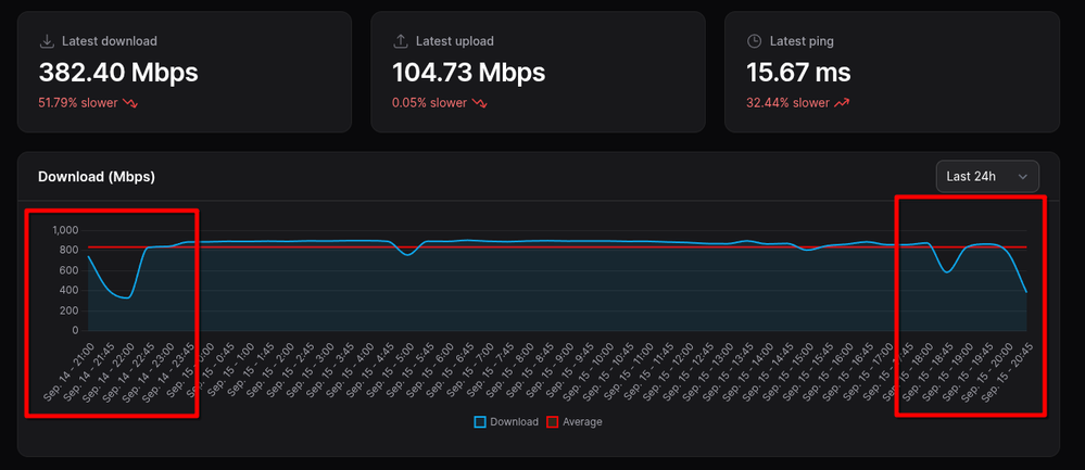

Openreach also worked on the pole I’m connected to earlier this week, which didn’t look like standard maintenance or customer connection, so this may be related. I have let it settle, but still getting poor performance. My Thinkbroadband graph shows a substantial increase in latency spikes.

@fjama1 wrote:... during maintenance on the evening of 11th / early hours of 12th September (Ref: PW1756817200) ...

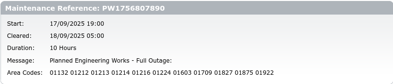

It looks like PW1756817200 completed as you said -
but are you in for potentially a ten hour outage on Wednesday and Thursday ? (possibly fixing your current issue)

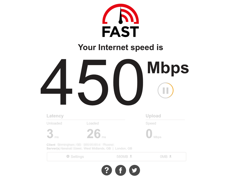

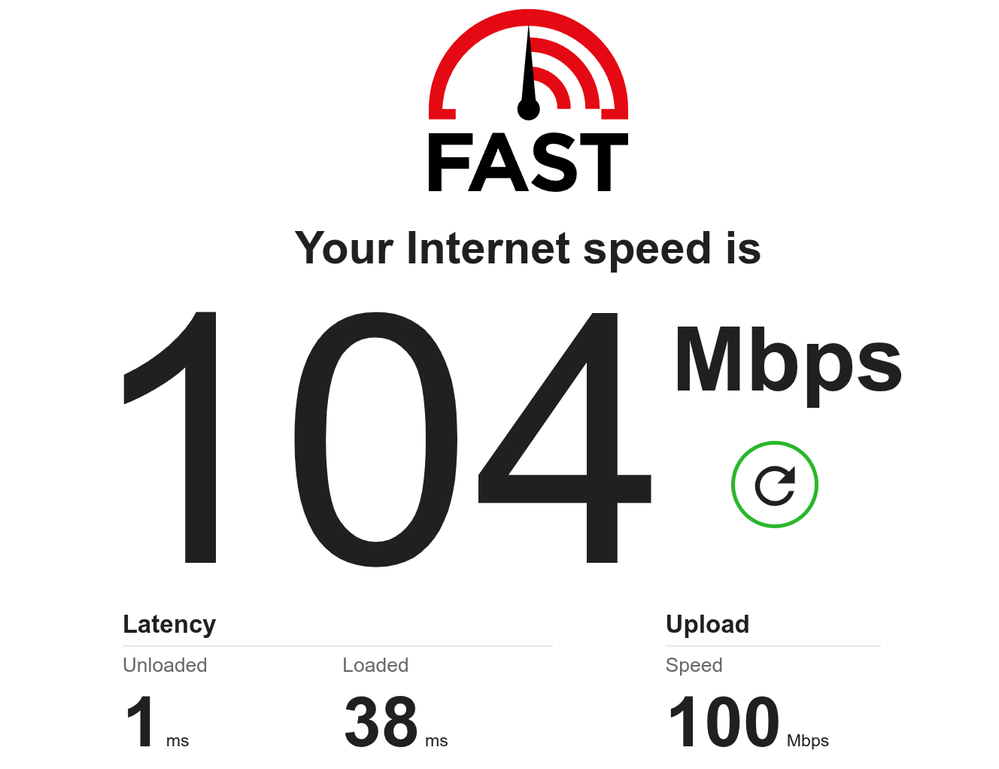

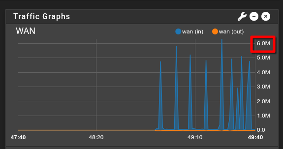

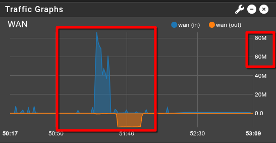

As shown above, I monitor download speeds, and it has dipped again last night and now. I have checked to see if link saturation is causing the loss of speed, but the link was barely being used (under 10mbps), and an ad-hoc speed test performed after my automated speed test alerted me showed very similar results.
normal usage before speedtest
The image above shows very low usage, clearly showing that my devices/firewall isn't the issue causing the slow speeds.
The image below shows the speed test result, below the minimum guaranteed speed as stated in my contract during the same period over the last couple of days.
Firewall usage during the speed test is shown below
There is upcoming maintenance, so hopefully it fixes it. If not, I will revert to mpd5 and see if it makes any difference. I am running a fanless n100 i226 router, which should be plenty for a 1 Gbit connection without any traffic shaping/traffic inspection/IDS/IPS or running heavy packages (like ntopng).
I would like someone from Plusnet to investigate this further.
