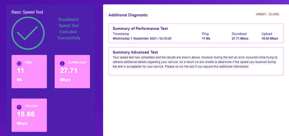

@brazclapz PN staff will no doubt catch up with this soon, but if you would like a  slightly quicker response 😉, this might help:
Can you report the information from these two sites:-
BT Broadband(obscuring your phone number) and BTW Performance Tester - Please report the 'Additional Diagnostics', and sight of the Help Desk tab would be a start.

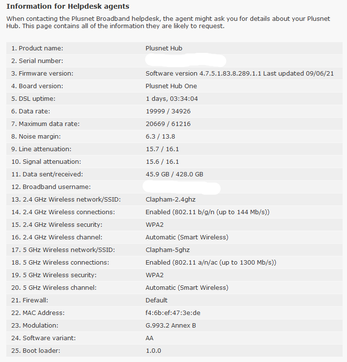

You certainly hava problem there, @brazclapz . Can you post your 'Help Desk' tab from the router please? Unfortunately, the last test date on the Availability Checker is way out of date, so no help.

.@jab1

Re: Sudden drop in download speed
Thanks for that. Something is way out of line there - your D/S data rate is way below what it should be, the D/S SNR is way too high, and - unless you are intentionally switching the modem/router off - your DSL uptime is suspiciously low.
I'm afraid there is nothing I can do further as a Community member, but hopefully one of the Help Team who are around can run the relevant check from their end.
