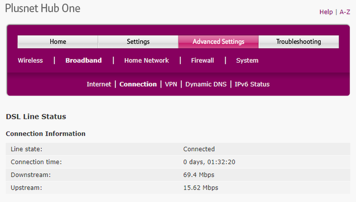

@BobR1 I mean your modem/router. Assuming it is a 'Hub1' log into it and find the page shown below:

Oh right - I get where you are coming from now. Your assumption is incorrect I don't use hardware supplied by Plusnet.
But I've attached the data from my Zyxel router. It's from the closedown last night but it hasn't changed at logon this morning

@BobR1 OK, sorry for my incorrect assumption about your kit. That data indicates there is absolutely no problem with the connection to your Master Socket - all figures are spot on.
