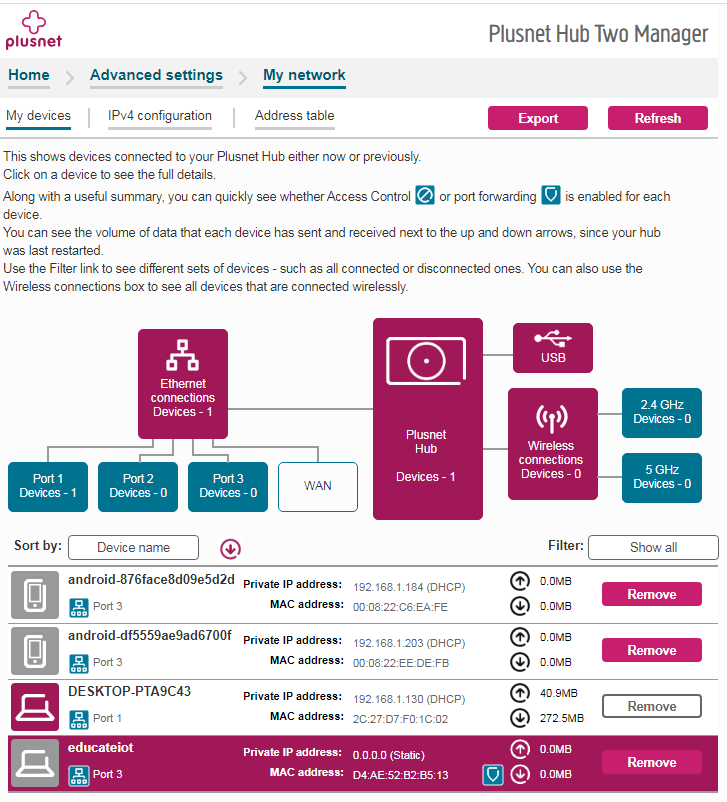

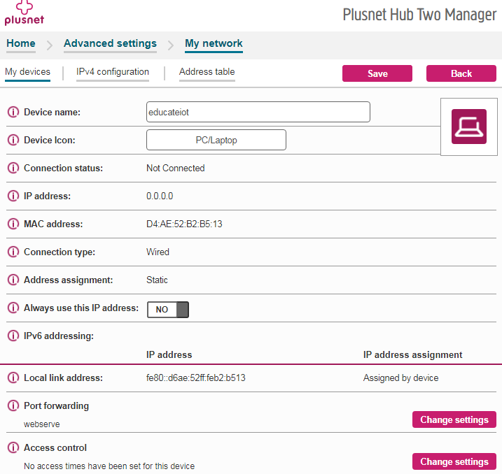

REPLY==> Yes! You are absolutely right and spot on. I did exactly as you stated above. I assigned a static IP of 192.168.1.15 to a PC with default gateway of Hub 2 router: 192.168.1.254. But this did not work, no connection with the router, router sees it as unknown device with static IP. See below
Devices on Hub 2 subnets. Bottom one with static IP
The bottom device: educateiot is a PC given a static IP of 192.168.1.15; Gateway is: 192.168.1.254 (Hub 2 Router)
There is no connection/communication as shown below:
This is where I am stuck at the moment and trying to work around that issue.

Sometimes the Hub won't 'see' devices that are on static ips. Try changing the device to dhcp and let the Hub allocate an ip. Then edit the device and select 'always use this ip' ,that will effectively give you a static ip BUT one that the Hub has allocated so it will 'see' the device.

If its working, then just edit the device on the Hub2 device list and select 'always use this address' , it's now a fixed IP address!
