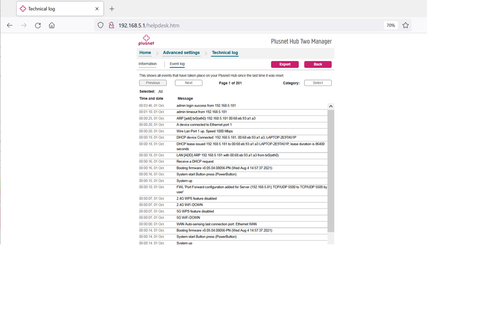

Can you confirm that the ONT lights are ok when the problem happens ? i.e PON light steady and LOS light OFF
If that's the case , then assuming you have a Hub 2 then could you post the event log when it next happens.
The full log, which we really need, is available from this page of your Hubs details. When you have got it - by clicking the 'Export' button, attach it to a reply
