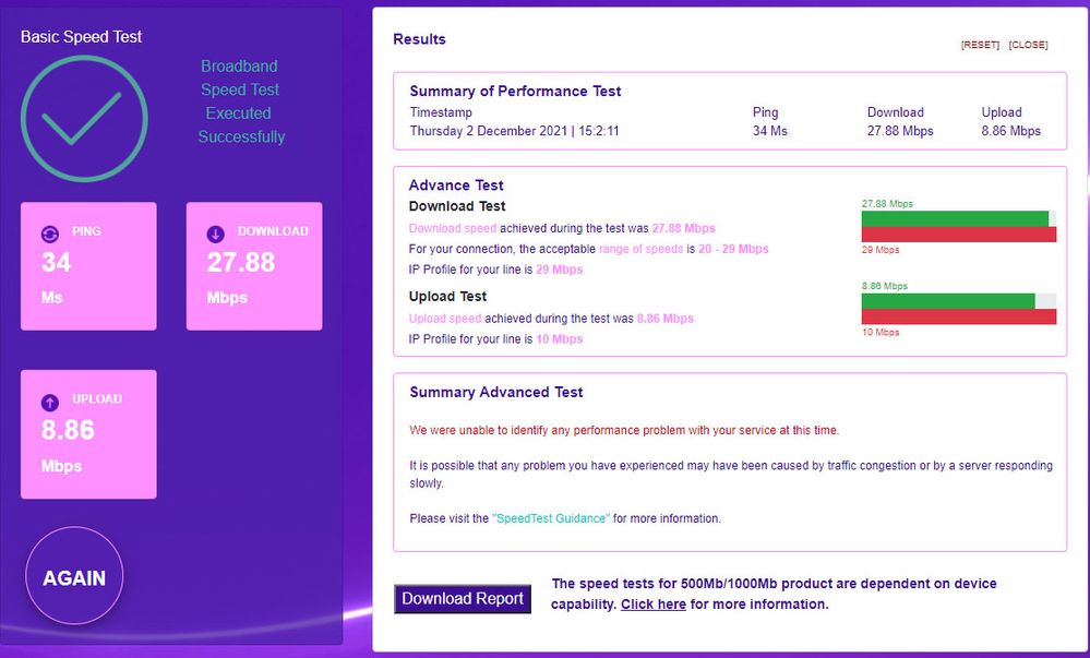

Here's a screenshot of the advanced BT speed test.

The speedtest results show that you are getting 27Mbps. The minimum guaranteed speed of 19 Mbps is totally irrelevant unless you are getting less than this.
Unless you are moving to FTTP or a cable company your new provider will use the same broadband connection so you are unlikely to see any improvement.
I can’t see much effort being put into either helping you to either get an improvement or improve your understanding of the limitations of your line if you are moving anyway.

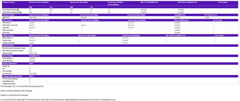

Thanks for the response.
Here's a screenshot of the broadband checker.
Re: Slow speed so had to switch provider
02-12-2021 4:21 PM
I'm not certain what's happening with your line. From the checker you should be getting at least 40 down, with a minimum of 32 (if I understand these things).
What perhaps is on more importance is you can get FTTP - it shows as WBC FTTP in the left hand column with Available shown to the right. This means you can get super duper speeds if you so wish.

@Bren88 If I were you I would forget about your FTTC connection and switch to full fibre FTTP which is available to you. Speeds up to 1000Mbps available, you can get 80/20 speeds for a similar price to FTTC. Plusnet don't offer FTTP yet but they will let you move to BT or EE with no penalty.
