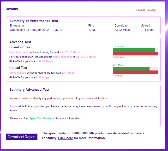

@dougjbarnes1 Can you please post a screen shot of the result of the 'Advanced Diagnostics' from: BTW Performance Tester
Re: Slow fibre Broadband
23-02-2022 1:41 PM
According to BTW my maximum line speed is NOW ~25M, back at the start of the year it was ~35M, so why a 30% decrease, what has changed?

The reason I'm asking is that I've run a GEA test from our end this morning, speeds are coming through at 40Mbps. Can you please send us a screenshot from the Helpdesk page on your Hub One? Make sure you remove the account username from the screenshot.

Just run again, ethernet , report enclosed
Helpdesk result
1. Product name: Plusnet Hub
2. Serial number: +081441+NQ70802124
3. Firmware version: Software version 4.7.5.1.83.8.289.1.3 Last updated 29/11/21
4. Board version: Plusnet Hub One
5. DSL uptime: 1 days, 09:22:23
6. Data rate: 8685 / 39950
7. Maximum data rate: 8684 / 47636
8. Noise margin: 6.1 / 9.5
9. Line attenuation: 30.2 / 22.0
10. Signal attenuation: 29.8 / 20.9
11. Data sent/received: 549.6 MB / 8.5 GB
12. Broadband username: ************@plusdsl.net
13. 2.4 GHz Wireless network/SSID: ********
14. 2.4 GHz Wireless connections: Enabled (802.11 b/g/n (up to 144 Mb/s))
15. 2.4 GHz Wireless security: WPA2
16. 2.4 GHz Wireless channel: Automatic (Smart Wireless)
17. 5 GHz Wireless network/SSID: *********
18. 5 GHz Wireless connections: Enabled (802.11 a/n/ac (up to 1300 Mb/s))
19. 5 GHz Wireless security: WPA2
20. 5 GHz Wireless channel: Automatic (Smart Wireless)
21. Firewall: Default
22. MAC Address: a4:08:f5:ad:fd:0a
23. Modulation: G.993.2 Annex B
24. Software variant: AA
25. Boot loader: 1.0.0
I'll try a couple more tests during the day
