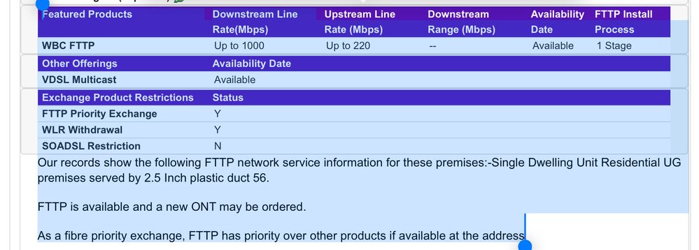

One would think OR would have noted the blocked duct - have a look at the following. What does it say about FTTP (to the right of WBC FTTP and below the results window).

If you're talking about the Checker use the Address verson - enter your post code only and select your address from the drop down list.
Markwallwork0
Posts: 51
Registered: ‎01-10-2018
Re: Second attempt to move to FTTP queries
Thanks right I’ve checked that it said fttp was available
Install 1 stage doesn’t mention anything about my blocked duct so the open reach engineer mustn’t have made any notes . Great

On the plus side if it's showing a 1 stage then it means openreach don't have a record of an installed ONT. Good thing is it means it'll definitely go as a booked engineer to the home so you can make sure they don't cut off the sogea line before sorting the ducts for fttp.
Honestly this is probably the best realistic outcome-at least an engineer will ID the issue and should keep you running in the interim rather than an attempted activation based on records, cutting you off before it's ready.

As regards to FTTP, I was particurally interested in exactly what it says about FTTP below the Checker results window.

InfoInfo
Markwallwork0
Posts: 51
This is the full info

1. if I put an FTTP order in will openreach already know about the blocked duct and sort this before giving me a date or will I end up with an engineer coming in again only to go away to get someone to do the work
The above data shows that the blocked duct has not been recorded, so this will cause you issues in the future.

As already stated, it does not appear OR know about the blocked duct or the installed ONT.
If you do go for FTTP make sure PN know the situation and inform the OR installer on the day when they show up. Once an installer is onsite they may have to cancel the job and pass it onto an OR groundworks team to sort out the duct. He might check the serial number on the ONT (if you ask nicely) to see if that's registered at all.
