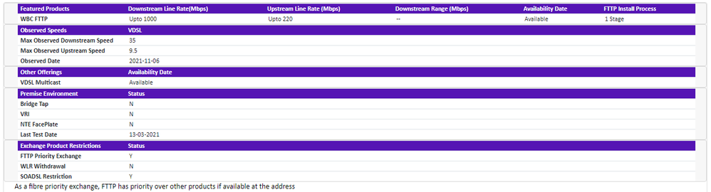

BT Broadband
Featured Products Downstream Line Rate(Mbps) Upstream Line Rate (Mbps) Downstream Range (Mbps) Availability Date FTTP Install Process
WBC FTTP Upto 1000 Upto 220 -- Available 1 Stage
Observed Speeds VDSL
Max Observed Downstream Speed 35
Max Observed Upstream Speed 9.5
Observed Date 2021-11-06
Other Offerings Availability Date
VDSL Multicast Available
Premise Environment Status
Bridge Tap N
VRI N
NTE FacePlate N
Last Test Date 13-03-2021
Exchange Product Restrictions Status
FTTP Priority Exchange Y
WLR Withdrawal N
SOADSL Restriction Y

Thanks for those two messages. Good to see the phoneline isn't an issue - which kind of points to the VDSL side of things.
The Availability Report indicates you can get FTTP - but not with PN  (at present). As a point of interest, it is better to post a screenshot, as there may be detail on there which you may regard as irrelevant, which is/could be useful.
