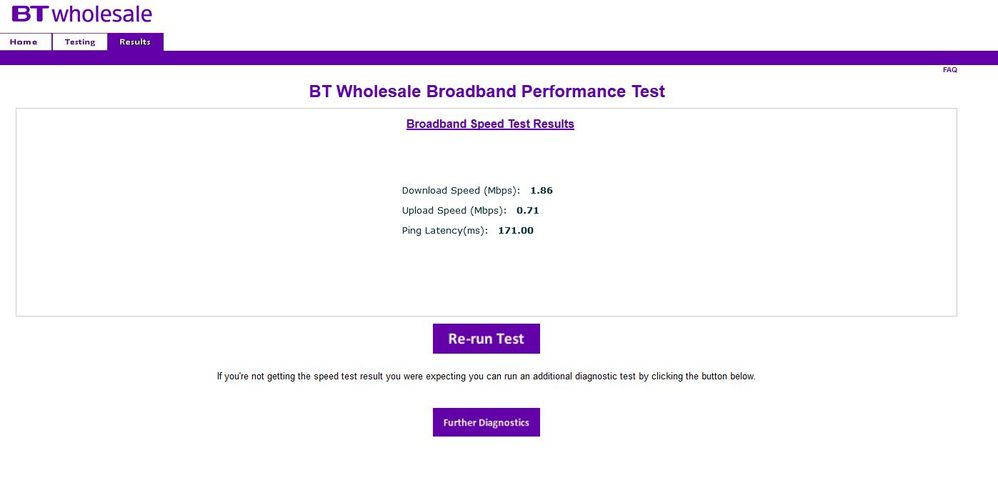

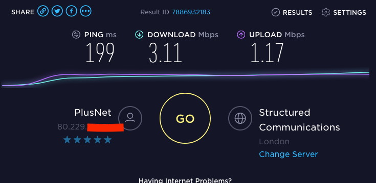

Anoush,
Same time of day again (late morning to mid-late afternoon) & speed has dropped again as per my Twitter DM.
Cat5 direct to router on master socket with all internal extensions & other devices disconnected from it.
Was 22Mbps down earlier this AM.
