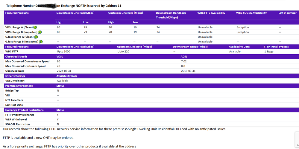

@geoffers first thing to establish is whether FTTP is available and how it will reach your property
Use the BT wholesale checker https://www.broadbandchecker.btwholesale.com/#/ADSL/AddressFeatureProduct
Assuming it shows as available , then the narrative below the availability matrix will say something like
Our records show the following FTTP network service information for these premises:-Single Dwelling Unit Residential OH Feed with no anticipated issues.

@MisterW  Brilliant, many thanks for that - it confirms FttP is available 👍, but still doesn't really resolve whether the cable will be overhead to the back or ducted to the front.
Is there something else on the report which will help identify this?

Read it again @geoffers , "OH feed with no anticipated issues" Wink

@RobPN  Aha 😂 too many abbreviations on the report, so missed the OH=overhead ... thanks Thumbs_Up

@geoffers so it will be served overhead from the existing pole. If the existing cable is to the back of the property , then the installation engineer will likely want to prefer to put the CSP (external grey box) and ONT at the back of the property. There is some flexibility on placement though and you will need to discuss that with the engineer on the install date. If you wish it routed through the loft as previously, then installing ducting and a drawstring will help enormously
