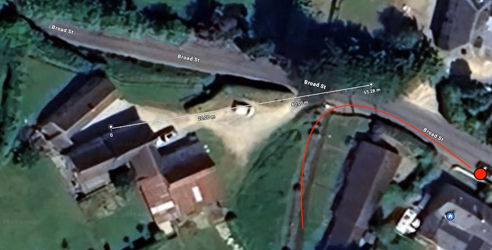

Thanks.
For further context the layout is like this. The overhead line runs along the ruler from a pole on the other side of the road. My in situ conduit terminates at the driveway at roughly the '40m' mark. Unless I'm very unobservant the nearest comms cabinet is out of shot in the direction of the red dot, and there is definitely a comms channel that runs along the red line (and actually may continue along the main road too).Untitled.jpg

FTTP doesn't go anywhere near the FTTC cabinets. It runs from a main Exchange all the way to your property. The network is also "planned" for capacity. Even if the is a duct along the red line it may or may not have fibre cable in it.
You could ask on the day of install and perhaps cancel the installation if the OR engineer thinks there may be a possible alternative route. They certainly would not be able to a take a decision there and then.
