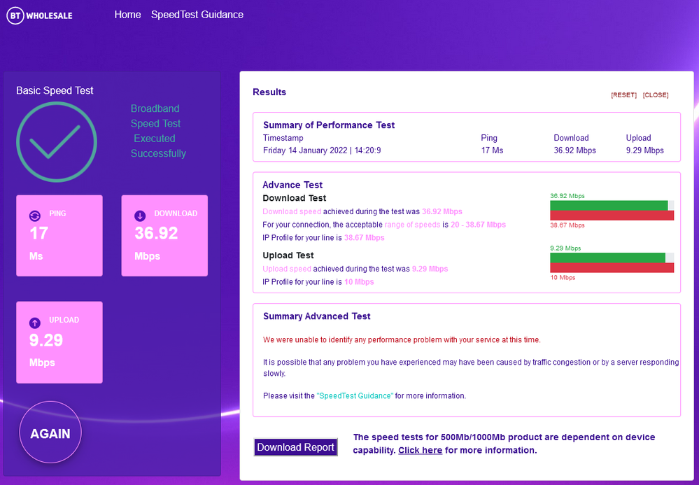

Openreach engineer came today and identified the problem as being too many junctions. Even before the BT master socket (MS) there were two junctions, with the MS being the third. The extension that I installed had two junctions, one from the MS back plate and then another before it got to the wall socket where I plugged in my ‘Hub One’ (H1). That’s 5 junctions with the H1 being plugged in at the end.
The engineer first of all established that there was no loss over the extension I installed (phew), the speed being 32 Mbps at both ends. He bypassed all these junctions by installing a new cable direct from the first incomer inside the property to a new filtered faceplate MS, where I needed the H1. He then “reset the internet speed” (his words, so don’t ask me what that means). The result is amazing. I am now getting 37 Mbps download and 9.29 Mbps upload, which is what I expected so I am happy again. He said that the speed will take some days to settle down but it is a promising start knowing that I now have a direct line to the new MS and I no longer need additional ADSL filter. Hopefully the line will now be stable but I'll post again in a week or so to confirm.
He was here over 3 hours and I commend Openreach and his efforts. There’s a lesson there for Qube who were here for 5 minutes and did nothing.

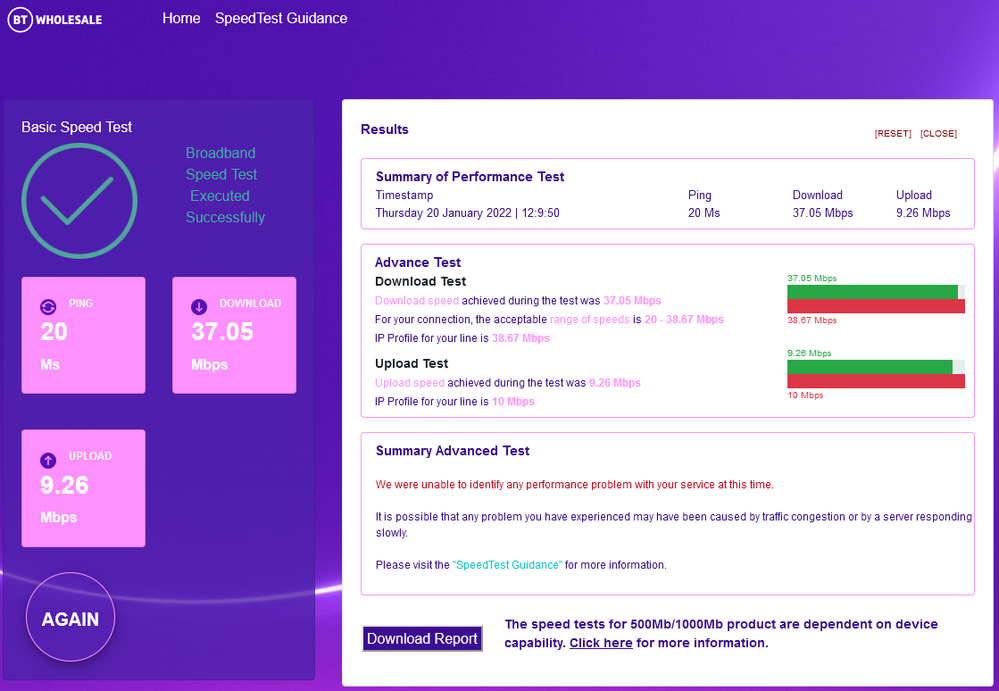

20-01-2022 12:17 PM
It is now 7 days since Openreach installed the new phone line and I am pleased to report that everything seems stable so I will call this thread ended. Thank you all.
