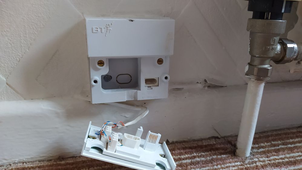

The extension is hard-wired into the back of the master socket faceplate. The other end is securely screwed to the wall near my router. Extension hard wired.jpgEnd of extension.jpgSee photos.
I'll delay moving the router to the test socket until tomorrow. I need the internet for today.
Maybe the photos will help?
Posts: 17,475
Thanks: 7,075
Fixes: 488
Re: Plusnet ‘Unlimited Fibre’ speeds not as fast as expected
How many wires are connected to the faceplate ?
There should only be two , the blue & the white/blue connected to pins 2 & 5.
If there's a connection on pin  3 then that will be affecting the speed when connected to the extension socket.
See here https://kitz.co.uk/adsl/socket.htm for explanation about the 'ring wire' , its effects and how to remove it.

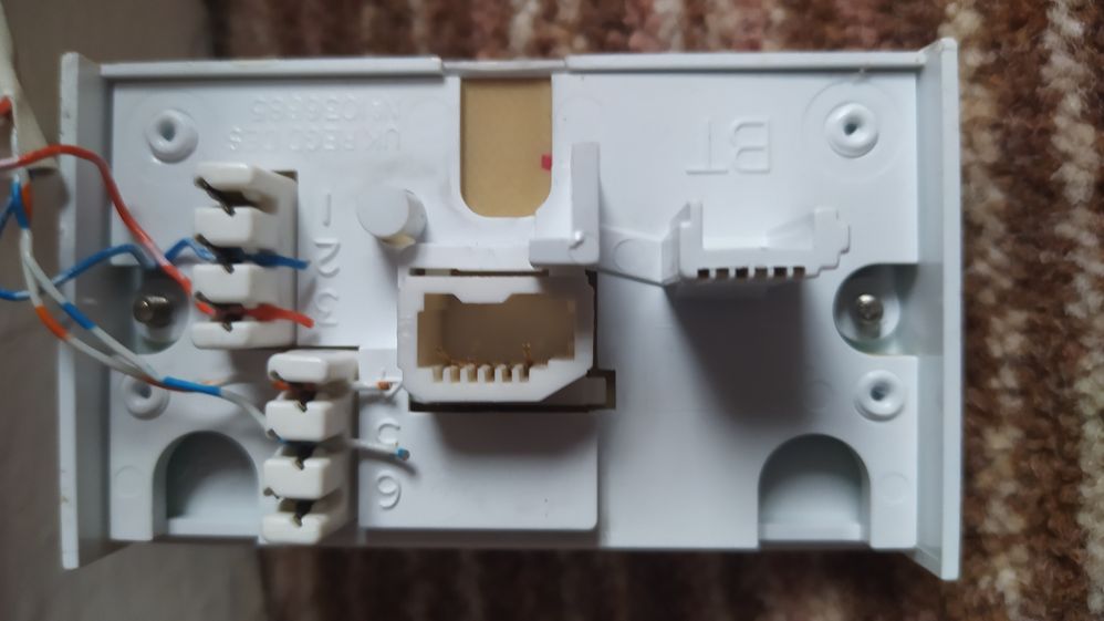

Madeleyite
Posts: 134
Thanks: 26
Fixes: 5
Registered: ‎19-03-2016
Okay, I have checked the extension wiring and find that there are 4 wires connected. See photo. This dates back some years so maybe back to pulse dialling.I don't know.
Is it safe to disconnect wires from 3 and 4 to leave just 2 and 5 connected?
flanzm
Posts: 252
Thanks: 79
Fixes: 15
Registered: ‎20-04-2016
Yes you only need pins 2 and 5 connected.
3 would have been connected to provide a ringer for the extension, and may generate interference as it will act as an aerial.
4 would have been connected just for neatness
Assuming their is only one extension being run off the master socket I can't see that being the cause of the bridge tap.  A bridge tap is basically a length of wiring that isn't properly terminated (at a socket) this causes reflections/interference on the line.
Does the sync improve when you run the router in the master test socket as @Townman  says (i.e. disconnect the extension wiring completely).  Note you may need to leave it connected to the test socket for a few days for DLM to backout it's changes.
If after a few days it still isn't working in the test socket then the fault is likely to be external to your property, and way well be an external bridge tap.

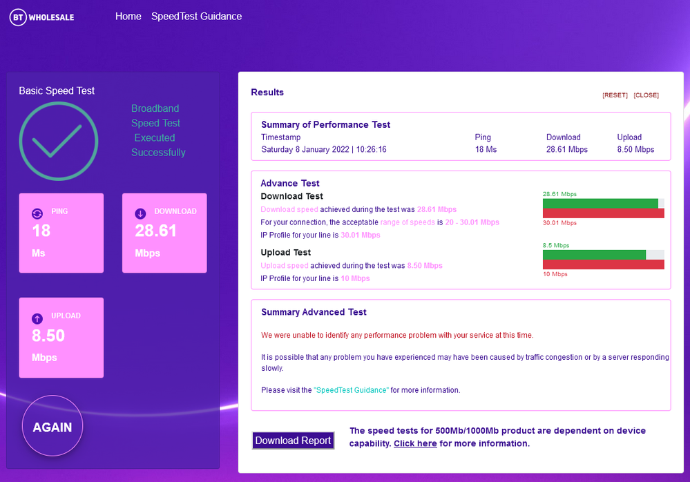

It isn't practical for me to move my router to the BT Master/Test socket so I won't be able to do that particular check.
Yes, there is only the one extension and I have disconnected the wires from terminals 3 & 4 at both ends. There is now only 2 & 5 connected but the situation is no better. In fact the speed is now below the minimum guaranteed speed of 29.2 Mbps. See photo: -

@Madeleyite you may not see an immediate improvement on the speed test as it can take a while for the IP profile to improve.
What would be useful is to see the Helpdesk details from the router again to see if the synch speeds & noise margins have changed

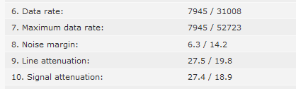

Here are the latest Helpdesk data lines 6 to 10: -

You need to be observing and comparing the SYNC speed of the physical connection as reported by the help desk section on the Hub One.  The BT Wholesale page you are running is measuring the IP throughout of the connection, and isn't reliable enough for fault finding.
What we are trying to do here is determine if changes to the wiring are making a difference to the SYNC speed (not the IP throughout, which may take time to adjust to changes in the SYNC speed, and can be affected by way too many factors to be of any use to us here).
I assume you can't plug the router into master socket because you don't have a long enough ethernet cable ?  If so does your computer have WiFI - if you move the router and connect via WiFI you will be able to see the effect of changes in SYNC by looking at the router help desk page (ignore the throughput for now).  If your computer doesn't have WiFI can you use a mobile phone to view the page ?
When diagnosing FTTC issues it's essential get stats at the master socket, because that represents the best figure you will get from your line and is all Openreach will care about.  Extension wiring is well known for causing major issues and it would be good to rule that out before progressing with an engineer visit.
