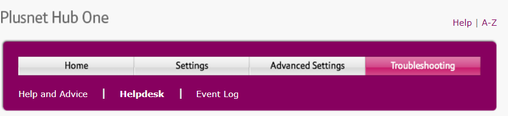

@Madeleyite
As advised Troubleshooting >Helpdesk
These lines
HTH

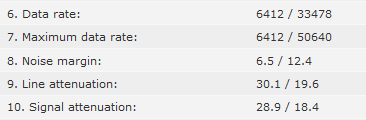

Here is what is showing in lines 1 to 10 as per @Dan_the_Van post: -
Do these help?

Right, we now have some objective facts to look at.
The line is being managed for stability and the cause for that needs to be identified by following a standard diagnostic process.  The DS SNRM is 12dB, normally on an excellent line, one would hope for just 6dB.
The sync speed of 33.478mbps will give a data profile of 32.4mbps and data throughput will be a little under that.  You have stated that your actual speed is not causing any impact on your internet usage ... tuning this will need some effort from you ... but probably to no material benefit.
Anyhow, lets look at the standard diagnostic processes...

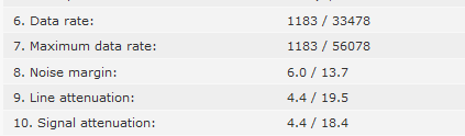

Here are stats after the router resuncd: -
