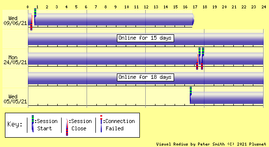

Hi @MJN I've had a look into this for you and it doesn't look like there's anything this side causing the drops.
What we can see agrees with what you've said about the two drops and line tests are also showing all's OK.
I've attached a copy of our testing below as well as the connection logs from the last 30 days or so:
It's difficult to investigate further as they're just singleton drops but I'd start by looking at the router.
Do you have another one you can try and see if it makes a difference?
Posts: 26,865
Thanks: 10,699
Fixes: 1,629
Registered: ‎21-04-2017
Re: PPPoE error: Timeout - What's happening?
