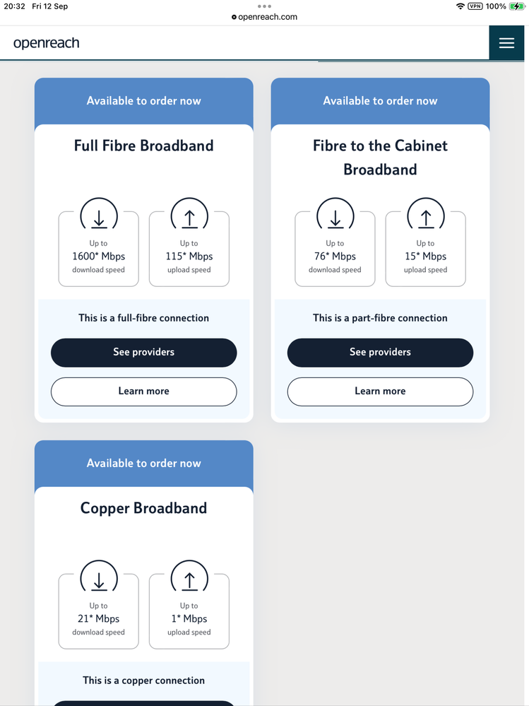

trippy
Posts: 21
Thanks: 4
Registered: ‎26-08-2013
Re: Openreach says i have FTTP but Plusnet says i don't
It’s annoying that it doesn’t filter through quicker. Openreach are saying it’s there on their websiteIMG_0891.png
Posts: 22,394
Thanks: 7,784
Fixes: 332
Openreach are notoriously lax at updating important data - you just have to be patient, unfortunately.
Posts: 4,932
Thanks: 1,765
Fixes: 85
@trippy
Use the Address version of the Checker. Enter your post code only and select your property from the drop down list.
Is your Address correct?
It could be an OR Database error or, as stated, it hasn't caught up yet.
Full Fibre is installed in "circuits" so it's possible where you saw installs taking place they are on a circuit which has been commissioned whereas you're on a circuit which either hasn't or was brought live at a later date.
Also check your next door neighours address. You never know.
trippy
Posts: 21
Thanks: 4
@bmc Thanks have checked both my neighbours addresses that Openreach where installing to and neither are showing any different to mine. Will just have to wait or move to BT
