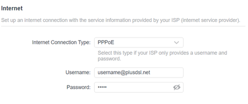

@joe90bass welcome to the forum.
I suspect you are using Dynamic IP for the WAN IP Address which is incorrect you need to configure the WAN to use PPPoE adding your broadband username and password in the appropriate fields.
HTH

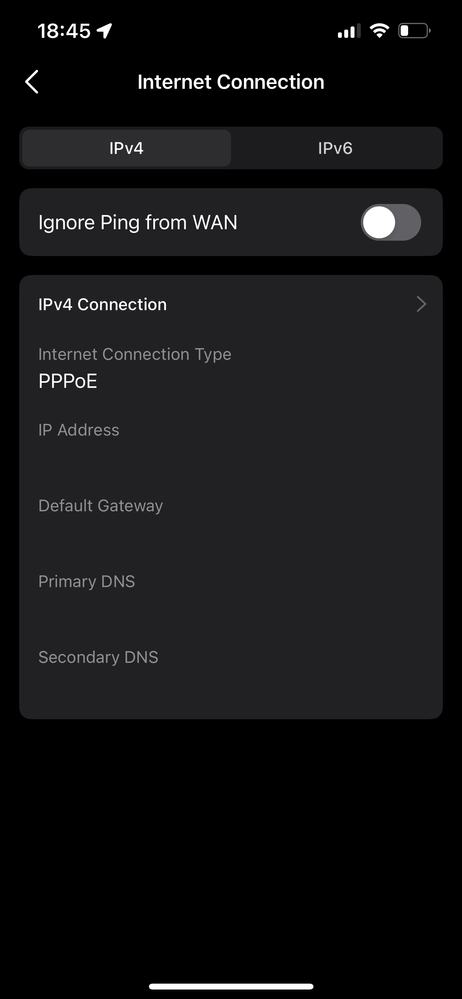

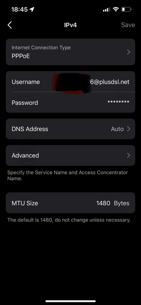

Re: ONT IP address
This is the settings in the Dec XE75, these worked until Thursday lunchtime. The IP address did show an IP previously
