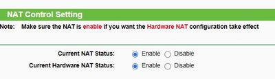

Is Hardware NAT enabled on the TL-WDR3600 ?  Apparently it is a setting.

Just checked NAT. It is enabled.
