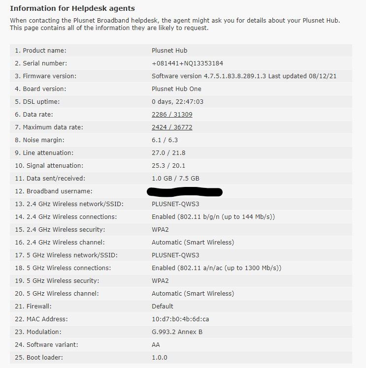

Thanks for those two reports. Despite the BTW speed test claiming to be unable to identify a problem, you do have one, in that your upload speed is woefully lacking, and the Availability Checker suggests that you should be getting closer to 40 download.
They look a little inconclusive to me, so, with apologies for asking for more data as I am unable to see what PN Support can, could you (if using the PN supplied Hub), post the Help Desk page from that, along with the WAN log from the Event Log?

WAN Log:
16:43:08, 08 Dec. ( 99.170000) WAN operating mode is VDSL
16:43:08, 08 Dec. ( 99.170000) Last WAN operating mode was VDSL
16:43:07, 08 Dec. ( 97.760000) PPP IPCP Receive Configuration ACK
16:43:07, 08 Dec. ( 97.740000) PPP IPCP Send Configuration Request
16:43:07, 08 Dec. ( 97.730000) PPP IPCP Receive Configuration NAK
16:43:07, 08 Dec. ( 97.730000) PPP IPCP Send Configuration ACK
16:43:07, 08 Dec. ( 97.720000) PPP IPCP Receive Configuration Request
16:43:07, 08 Dec. ( 97.700000) PPP IPCP Send Configuration Request
16:43:05, 08 Dec. ( 96.420000) PPPoE is up -​ Down Rate=31309Kbps, Up Rate=2286Kbps; SNR Margin Down=6.3dB, Up=6.2dB
16:43:05, 08 Dec. ( 96.400000) CHAP authentication successful
16:43:05, 08 Dec. ( 96.340000) CHAP Receive Challenge
16:43:05, 08 Dec. ( 96.340000) Starting CHAP authentication with peer
16:43:05, 08 Dec. ( 96.340000) PPP LCP Receive Configuration ACK
16:43:05, 08 Dec. ( 96.330000) PPP LCP Send Configuration Request
16:43:05, 08 Dec. ( 96.320000) PPP LCP Receive Configuration Reject
16:43:05, 08 Dec. ( 96.320000) PPP LCP Send Configuration ACK
16:43:05, 08 Dec. ( 96.310000) PPP LCP Receive Configuration Request
16:43:05, 08 Dec. ( 96.310000) PPP LCP Send Configuration Request
16:42:53, 08 Dec. ( 83.890000) PTM over DSL is up
16:42:03, 08 Dec. ( 33.950000) WAN Auto-​sensing running.
16:17:57, 08 Dec. ( 134.520000) WAN operating mode is VDSL
16:17:57, 08 Dec. ( 134.520000) Last WAN operating mode was VDSL
16:17:56, 08 Dec. ( 133.420000) PPP IPCP Receive Configuration ACK
16:17:56, 08 Dec. ( 133.410000) PPP IPCP Send Configuration Request
16:17:56, 08 Dec. ( 133.400000) PPP IPCP Receive Configuration NAK
16:17:56, 08 Dec. ( 133.390000) PPP IPCP Send Configuration ACK
16:17:56, 08 Dec. ( 133.390000) PPP IPCP Receive Configuration Request
16:17:56, 08 Dec. ( 133.390000) PPP IPCP Send Configuration Request
16:17:55, 08 Dec. ( 132.460000) PPPoE is up -​ Down Rate=29793Kbps, Up Rate=2324Kbps; SNR Margin Down=6.6dB, Up=6.2dB
