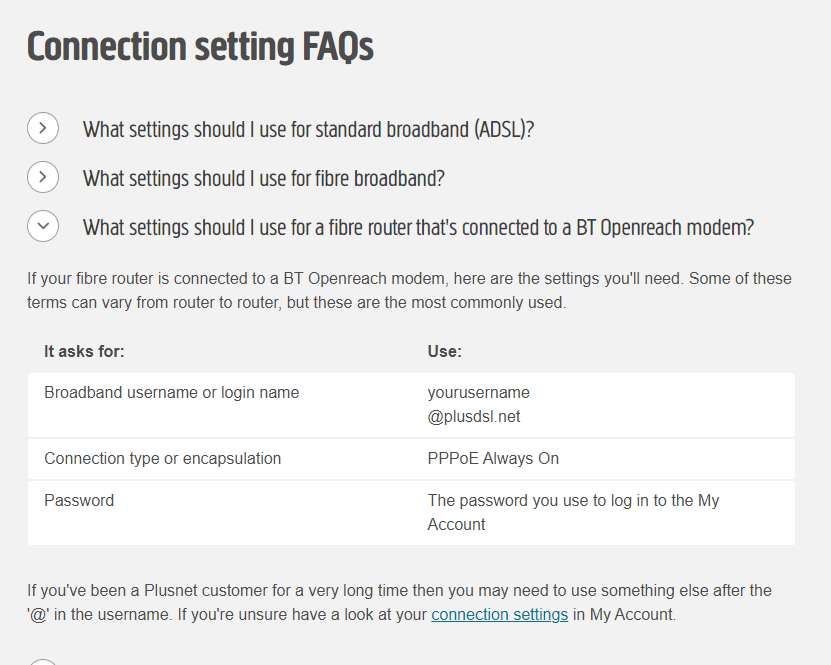

I'm not familiar with the eero - but as no one else has responded...
I suspect you need to change the login details on the eero. Details are shown here https://www.plus.net/help/broadband/broadband-connection-settings/
If it has a setting for VLan, it should be set to off or 0

@lukeheald  If you are certain that your Giganet service was supplied on the Openreach network with an Openreach ONT installed you just need to change the to the Plusnet login details on the Eero as @IMM suggests.

Assuming that your Eero router has not been locked down by Cuckoo you should factory reset it and start again using the settings provided by @IMM  in post #2 (https://community.plus.net/t5/Full-Fibre/New-customer-existing-ONT/m-p/1991573#M25702)

Here's the instructions for setting PPPoE on the Eero https://support.eero.com/hc/en-us/articles/5382599417371-PPPoE-Setup-Instructions
Note that not all Eero devices are capable and some may also require a firmware update

If you want to check your connection and have an Ethernet enabled computer you could temporarily connect it directly to the ONT and set up a PPPoE connection using the details provided in Post #2.
