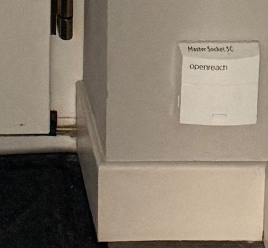

Getting FTTP installed. Previous owner has it set up so that the landline socket is above the front door (and another socket is to the side of the door)
I don’t think either of these work for fibre so a new socket needs installing - is this likely to be a problem for the engineer, particularly if a fibre cable needs running to the house? Images below should clarify regarding location

@4rmst strange that you appear to have two Openreach master sockets,  one to the right of the door, a 5c with no faceplate and the one above the door , a 5c with a Mk4 dual faceplate.
Does the incoming cable feed the one to the right of the door ?
From what I can see it shouldnt be a problem to locate the ONT in either of those places. The incoming fibre is terminated in a CSP (customer splice point) which is a grey plastic box located at ground level on an outside wall. The fibre then goes through the wall to the ONT located inside (usually) opposite the CSP.

I was trying to figure out where the copper cable comes from to get to the MS. You should be able to see where it emerges from the ground and from that figure out a route to the Master Socket.
The ONT can only go above the door if there's an easy way to get to the other (external) side of the door. I can't see from the picture but how is the porch finished - is the roof open or has it been sealed off?

Actually looking at the pictures again can I see the cable on the outside just to the left of the door? It appears it may come through the porch about a third of the way up.

I would check in here to see if the incoming phone cable comes through and the direction it's going
Looking inside.
To the left of the front door I suspect there is a downstairs toilet which will be the reason behind the phone line coming to the right of the front door.
To me enlarging the picture I am wondering if there is some cable trunking running along the floor below the door
The trunking would be something like https://www.screwfix.com/p/d-line-pvc-white-micro-trunking-16mm-x-8mm-x-2m/86007
Without taking the faceplate off both Openreach master socket it will be impossible to say which is the master, they are both marked up as Master Socket, but I suspect it will be the floor level one.
Alternatively there is a void above the porch has had a ceiling fitted, the cable could run across here
