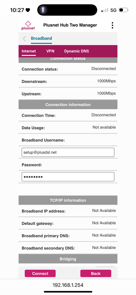

I spoke to Plusnet again and the lady made me go into advanced settings and broadband settings on the router. She said that my username and password should not be set up @ Plusnet….as shown in the picture I’ve attached. So she made me put in my actual username and password but it still didn’t connect.
Re: My router has broken
09-12-2024 10:37 AM
@JulieD42 That 'setup' username is there at the commencement, and should change when you first connect, but as you can't connect - the PADI issue - the system cant populate your credentials as it is supposed to do. Until the Plusnet network can 'see' you, nothing you do will have any effect.
I suggest you wait until the engineer comes and hopefully works out what the issue is.
