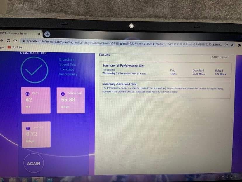

OK. Can you run that speed test on your sons laptop, connected by ethernet cable, and also re-run the BT Broadband  test, using your phone number?

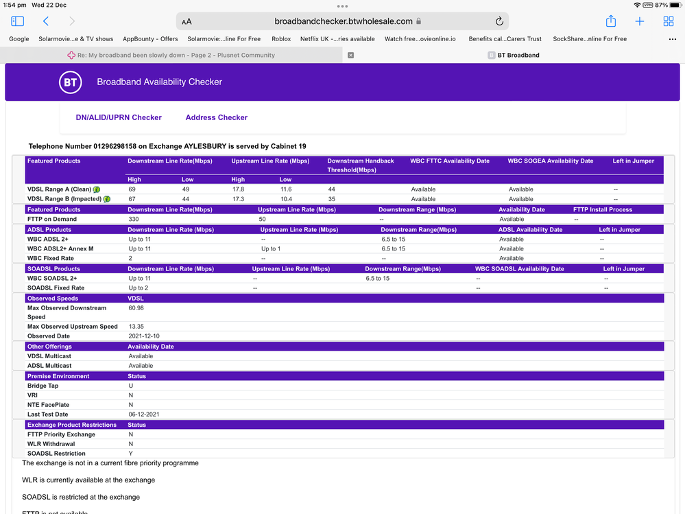

Thanks for the Availability checker, that kind of indicates you may have a slight problem in the BT network - the observed speed is below their estimates, but not by much.
