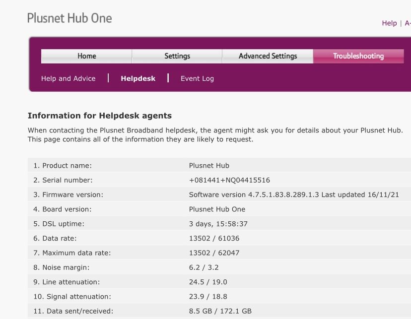

Screenshots are better for helping others help you, and as I said above, sight of your Hubs Help Desk page would be good, too. Without this basic information, there is little other Community members can suggest.

Thanks. Taking those two screenshots in order - the Help Desk picture indicates that you had a PPP drop (disconnection from the internet) 4 days ago in the early hours - has this happened before, do you know?
Also, your downstream SNR looks a little low, although with your attenuation the line should be able to cope, but it is something the PN Help Team can have a look at when they get round to this topic.

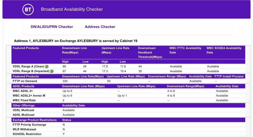

The BTW checker is not showing anything out of the ordinary, but using your phone number, rather than the address may give us a little more detail.
