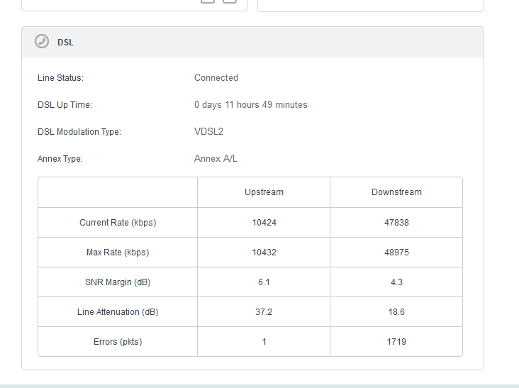

And has now reconnected with a 48Mb down (which is down slightly from its max of about 53) but the up has gone up from 7Mb to 10. - in all the time I've had this line it's never been more than 7 and a bit up.

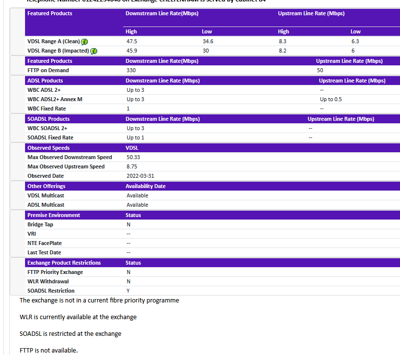

Line stats from BT show
And the router shows

Potentially overnight maintenance but it's hard to tell as line tests aren't showing any issues.
Currently the latest DLM profile we have from 31.03.22 is "Downstream: 0.128M-80M3dB with Retransmission (High). Upstream: 0.128M-20M with no error protection" but if you can prod me on Sunday, we should have an updated profile and if your speed's banded, which I suspect it might be, looking at that sync speed, I can reset your line.
