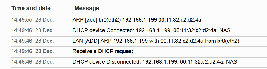

28-12-2023 2:38 PM - edited 28-12-2023 2:53 PM
Ignore me, I'll try again when my brain is in gear!
OK, still no joy:

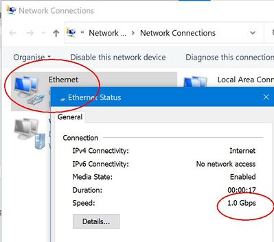

As already suggested by others, plug your windows computer into a LAN port.
Search and launch 'ncpa.cpl'
Double click on the Ethernet connection (may be labelled differently)
Check the Speed.

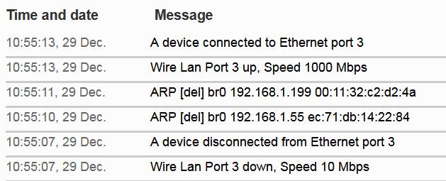

if you look at the event log at the exact time a device connects to the Hub you will see the connection speed, the event looks like this
hh:mm:ss, DD MMM. Wire Lan Port 3 up, Speed 1000 Mbps - this message is the port detecting a connection and negotiated speed
hh:mm:ss, DD MMM. A device connected to Ethernet port 3 - this message confirms the connection.
For 100 Mbps it would be
hh:mm:ss, dd mmm. Wire Lan Port 3 up, Speed 100 Mbps
These messages are not categorised so no filter can be applied to find them, these messages clear after a while so a search on the event log may not find them.
A port down message
hh:mm:ss, dd mmm. Wire Lan Port 3 down, Speed 10 Mbps - 10 Mbps is reported as speed negotiating starts at 10 Mbps.
Port can be 1, 2, or 3
HTH

29-12-2023 11:10 AM
My apologies for the duff information yesterday. I have tried again and as @Dan_the_Van says, it is shown, thanks Dan.
What I did yesterday to try it out was to unplug my NAS, which is connected via a switch. This disconnect is reported minus the speed as per my earlier post.
I have noticed scheduled back ups seem to be very slow the last couple of days and have noticed when trying this that whilst the switch reconnected at 1000Mbps it was only running at 10Mbps when I disconnected it. It was running at full speed so I have no idea what had happened. Whether this is relevant to this problem? I recall this happening once before.
