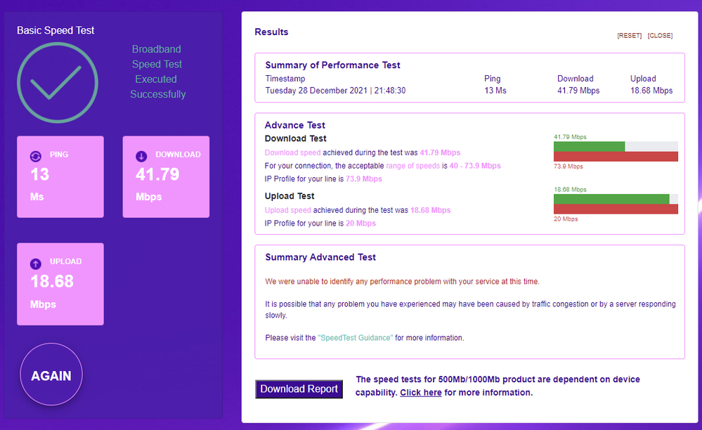

BT Performance Tester - done over ethernet (noted that the download speed is lower than we usually get. We average around 60mbps down usually)

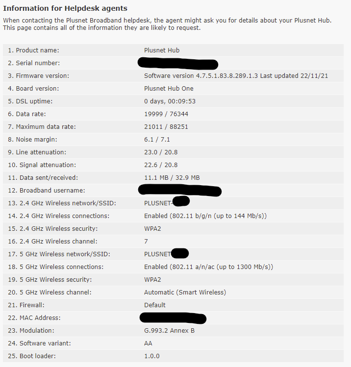

Hub "Helpdesk Agent Info" tab - I obfuscated some lines for privacy, but let me know if there was anything that needed to be seen:

OK - thanks for your quick response, too. The only things that jumps out at me at first glance, late at night 😉 are your DSL uptime, which indicates you have had a very recent DSL drop, and the low download speed, as you mention. I assume the Broadband Username is yours, and not '[email protected]'?
Based on that, any chance you could post the results from the WAN tab of the Event log, please? I probably won't get back to you until early tomorrow morning, but this looks like it may need PN Help Team intervention.

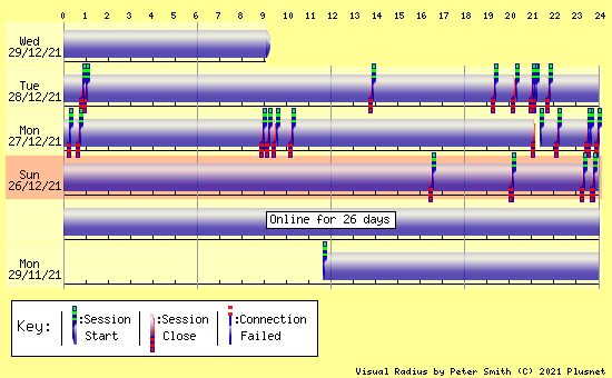

I've tested your line today and the tests aren't showing any causes for this but I can definitely see the drops as shown below:

I have tested the line again today and this hasn't highlighted anything, though can see a number of drops yesterday (I'm assuming the few drops around 5pm were from your checks in the test socket etc).
