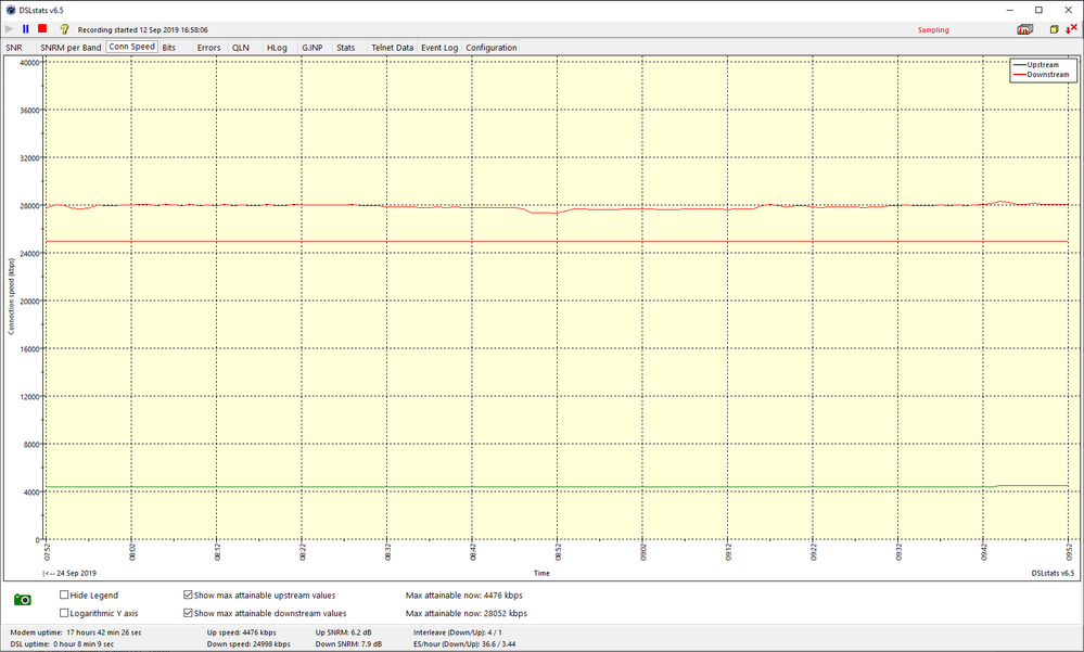

Yes thats right my line is around 650m to the Cabinet, isn't that where its measured to on VDSL broadband (going on the basis the closer you are to the cabinet the faster sync you should have), I thought the distance to the exchange was only relevant on ADSL Connections?
Normally my line will sync slightly higher than the attainable rate, below is a capture of the DSL Stats from before the problem started, the solid line is the Sync Rate and the other line is the attainable rate which is normally slight lower than my actual sync rate. Are you sure my line has not been banded as 24998kpbs seems a significant figure and if I reboot/disconnect the modem like I had to earlier to make sure I am plugged into the test socket, it reconnects at exactly the same rate 24998kpbs whereas normally if I reboot or disconnect it will reconnect at a different rate.

I still cant believe that from the stats I have showed that PN as still saying the line is not banded, so blindingly obvious due to my modems sync speed of 24998kpbs, as I said its stuck at that speed event when rebooting the modem, also the attainable rate is always lower than my actual sync speed, this is how its been for many years since G.INP was activated on my line.
Re: Internet Loses connection every night around midnight to 1am
24-09-2019 9:55 AM - edited 24-09-2019 9:58 AM
Just been browsing away and noticed that my browser said it could not find the page, checked the modem and it had lost the sync again, once again its reconnected at the same speed 24998kbps which would indicate the line is banded although you say its not!
Please could you explain why the GEA Test showed the profile as Downstream: 0.128M-40M with Retransmission (High) and Matthews alternative Test showed the profile as Downstream: 0.128M-27.4M with Retransmission (High), does this not indicate the line is banded?
As I said normally my line will go many months without a resync since last Thursday its resynced several times, something is definitely not right on the line.
Here are my DSL Logs which have been recording since 12th September as you can see since 19th September, I have had intermittent loss of sync

23 Sep 2019 16:10:07 No DSL connection
23 Sep 2019 16:11:10 DSL connection restored. SNRMup = 6.3 dB, SNRMdown = 8.2 dB
23 Sep 2019 16:11:10 Email alert sent: "Alert: Modem/router re-sync"
23 Sep 2019 17:05:10 Deleted snapshots in folder E:\OneDrive\HG612DSLStats\2019-08-22
24 Sep 2019 09:44:10 DSL connection restored. SNRMup = 6.1 dB, SNRMdown = 8.1 dB
24 Sep 2019 09:44:10 Email alert sent: "Alert: Modem/router re-sync"

As per Matt's response, the system called RRT(Reactive Repair Tool) which shows more in-depth information is more reliable when viewing banding than a GEA test and that showed the banding at 27.4mbps yesterday.
Ultimately if the BT systems don't show a sync speed to be restricted by banding then we cannot request a DLM reset. We've checked the RRT tool again and that is now showing your line to be banded at 25mbps.
A GEA Test is showing your sync rate at 23.9mbps however based on the banding we're seeing and the sync rate of your router, we've raised a request for a DLM reset which should go through within the next 2 working days.
Having said that, if your line is retraining then I'd recommend raising a fault to us at http://faults.plus.net so we can arrange an engineer to investigate this, because there'd be an underlying issue behind the retrains and the banding.
With that in mind, it's very likely that even if the request we've raised for our suppliers to manually remove the banding is successful, it's likely to be re-applied by DLM automatically if the retrains continue. Thank you.
