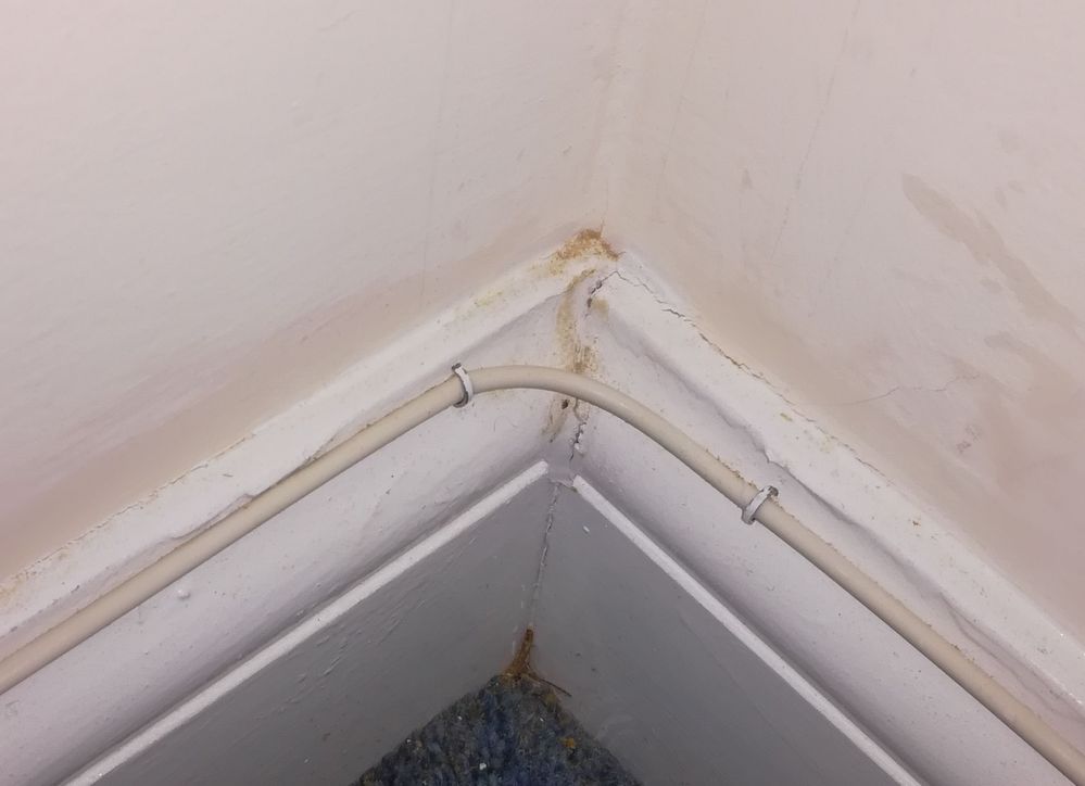

21-07-2025 4:32 PM
The CSP doesn't require any power. It is simply a box which protects the join between the external and internal cables.
Are you still fit enough to get into the loft. If so, then perhaps all the help that would be required would be to coil the fibre cable inside as it's fed through to the loft from outside.
Can you post pictures of the incoming copper cable, how it's run aound the loft and then the exit to the study. Below is a picture of my fibre cable being run to a back wall.
The bend wouldn't go any tigher than this.
If the installer is unhappy with your desired location they would look for alternatives to discuss with you.
