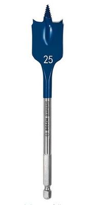

Have you not got something like this to drill a hole large enough. I have a 22mm and a 32mm one is an old drill set in the garage.
Drill a 25mm hole, the duct comes through easily and perhaps gaffer taped in place.
