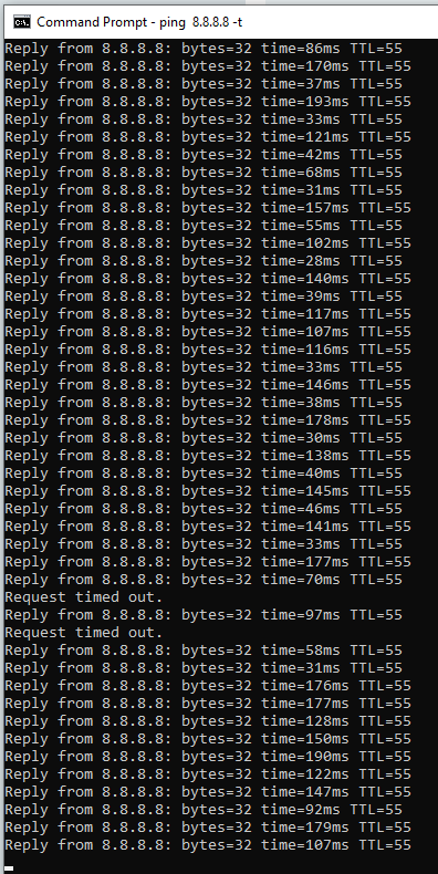

As expected, the Engineer cannot detect any problems.
It's afternoon on a weekday, there never is, as i've stated in previous posts this latency issue becomes a huge problem in the evenings.
Someone needs to come around when the problem actually exists. I've made it pretty clear with the screenshots, that this is a real problem.
I showed the Engineer this thread, my screenshots, logs of my tests and he see's that there is a real problem, but as he cannot detect one right now, there is nothing for him to trace.
I don't want to do this, but if this problem doesn't get resolved soon, I'm going to be submitting a report to ofcom about my service.
**Edit**
10 minutes after the Engineer left.
I did text the Engineer with this screenshot attatched, but unfortunately he has already put the job back and does not have access to get it back.
