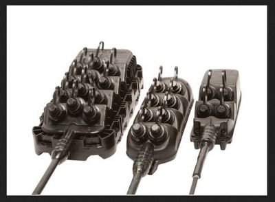

As previously stated, it may just be OR haven't completed the network install and were too quick off the mark with the e-mail. I would keep a close eye on the Checker.
If you are served by an overhead line you could look to see if something like the following has been installed. Similar units are put in u/g chambers but you can't see them.
