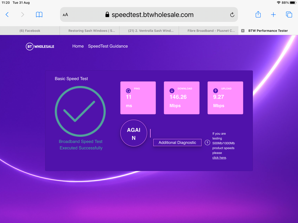

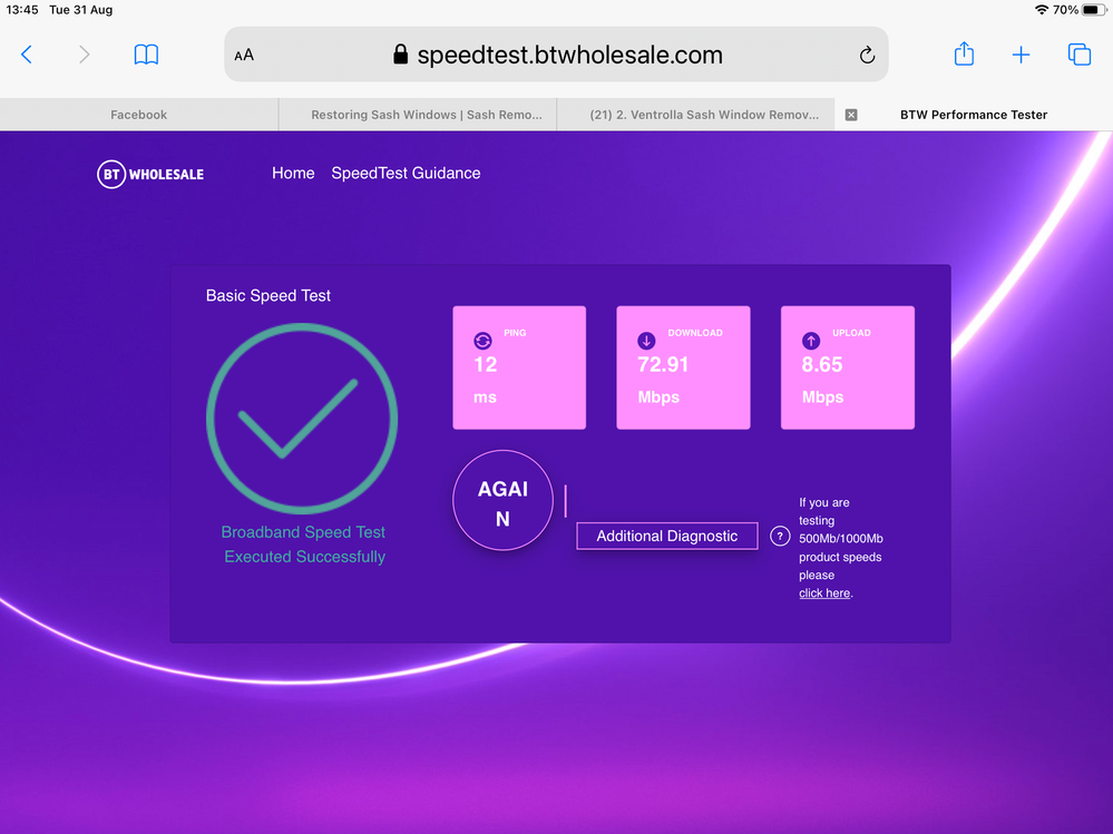

Thanks plusnet you lot are on the ball, yeah I know it says I have no outages, my system no telling me disconnected only telling me when reconnecting. done a couple of BT speed h is today. Not sure if that means anything. Thanks for getting involved F5742312-B68D-4983-9695-D242452F4D6B.png5CCC96F9-4A64-4F9C-8C08-407E8C51FEAC.png

@Catpuss Those speed-tests are totally fictitious - no way can you get that result on a 40/10 connection. What I have asked for, you can ignore - the details provided by @Gandalf confirm there are no external problems, so it looks like it is something in your internal set-up.
