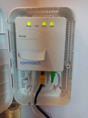

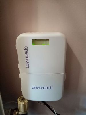

The following picture is of an internal CSP attached to the old MS back box. In this case there was a duct all the way to the MS so this was used. If you look closely you'll see the fibre cable coiled behind the ONT.
At the time this install was done (in NI) it was stated these boxes were rarer than hens teeth.

If the images don't appear by later today I'll re-post them as attachments. I'd save them so you can show them to any installer who states the CSP can't go indoors.
Is there a power source beside the MS? Two sockets ar required - one of the ONT and one for the router though you can locate this elsewhere.
